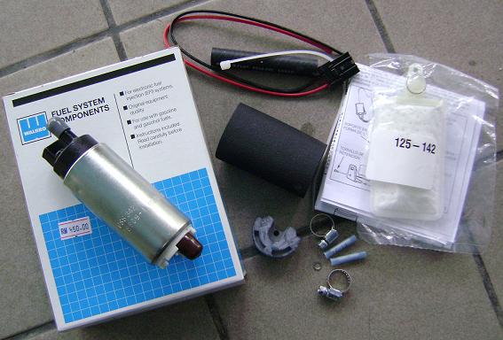

This is to share some of the experience I've come across after selling so many units of Walbro GSS342 fuel pumps. Yes, we even took out to see the internal guts of the pump. I am talking about original walbro pumps and not those fake pumps with plastic gears.
Walbro are great pumps for modified cars. As they are able to provide 255lph of fuel to the engine provided enough current is supplied to the pump. Not just that, it can support high pressure too. Fuel pump is like your heart. If it stops, so is everything else.
Prices has dropped drastically for these units as they are being sold as (pumps only) and you can source for your own filter unit and socket. FYI, they share the same power socket as most stock DENSO in-tank pumps. However, they are also available as in kits. Meaning, the filter unit, power sockets and install bits are packed into a single box for a specific application. But the price is of course higher.
