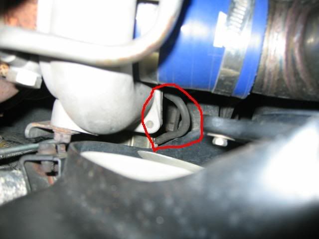

btw,u can run the car without connecting the wastegate actuator to the std solenoid.u can connect it to the intercooler piping pressure hole.im using this way and boosting around 0.8 bar on my evo4,u might got higher boost on later evo
here is pics of mine
