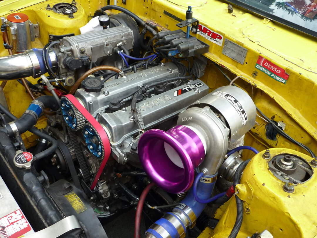

attached my ex engine 4age16v turbocharge 370whp @ 1.5bar 10krpm ,
play 4a turbo for the past 7 yrs and did a lots of 4a turbo for my other friend car as well .
now switch to sr20det :banghead: but still miss a lots of the feel of 4agte
plan to built 1 ultimate 4agte in future .
