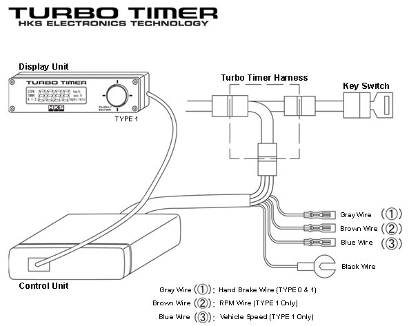

i want to ask something...i want to install hks turbo timer type 1 for my car,wira 1.5 manual carburetor.i want to know whether the "RPM FUNCTION and SPEED READING" can function on carburetor engine...please help me
speed reading ngn rpm tu function x???nk sambung kat mana??ni wiring diagram...carburetor mana ada ecu,so nk sambung kat mana wire (2) n (3) tu?
2 to tacho, 3 to speedometer, please take precautions before doing the wirings
u shud be able to read where the wires are located at on the meter's rear surface imo
if i not mistaken rpm can function but the speed cannot...
yeah, exactly what i told u. see if its work, if it doesnt den uve proven boi to be correct :smile:
