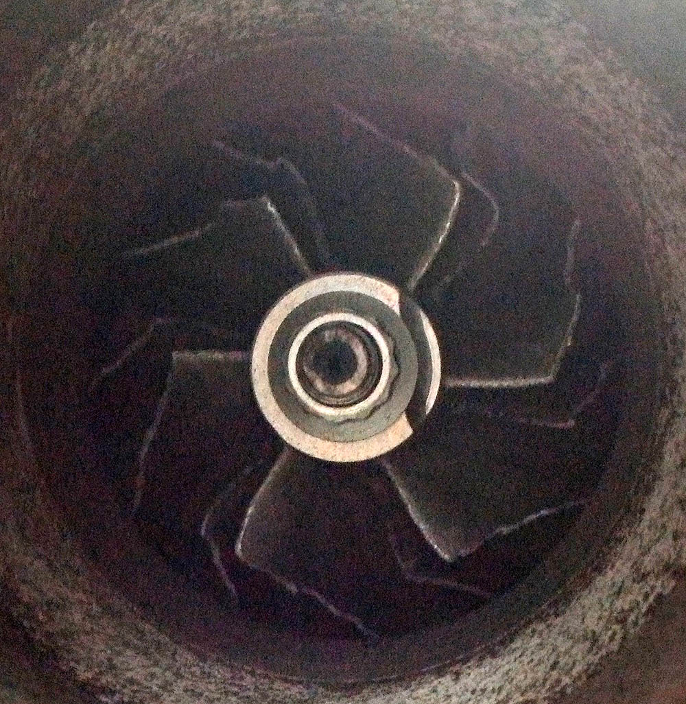

Sup folks.
Aside from SpeedSpin(droped fb pm) and Tong (too far for me; PJ), where else can i service my turbo near PJ area? Can i get it done within a day?
My compressor wheel damaged as it sucked a small piece of PU thru it =__=
So far no shaft play on compressor side.
Honestly, i have no clue what is the compressor trim of this T28. I will consider worse case scenario that i might need bigger wheel and do some porting.
What kind of budget im looking at?
Thanks

i think u will be better call the speedspin directly....they is quite late to reply pm.. (probably busy working)
I actually went straight to the shop.
mr.Firdaus gave me a walkthru on my turbo teardown.
It seems aside from the damaged compressor wheel (he believe it can be replaced by ca18/pulsar wheel), the bearing housing shows some not-so-good sign (scratches on thrust bearing).
Either manufacturer clearance issue or because i didnt use oil-restrictor.
Now im in dilemma w/ few options. Should i swap the bearing housing for a used T28 bearing housing(not sure if can easily find this part), or just assume (go by luck) its just because i didnt use oil restrictor and i just need to get one?
My FRP turbo is pretty much under ayam class, so i dont think i want to spend too much rebuilding it.
I did some scouting for turbos, and found used T25's going for rm850 =__=
