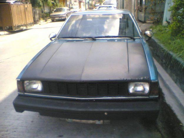

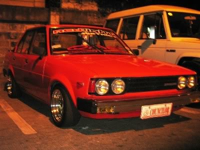

Just a simple question:
Can you change the square headlights of a 1981 Toyota Corolla with the 4 round ones? As and example,I've attached pictures.
I want to know if it is possible to change the square ones to the quad headlights with as little modification as possible.:confused:
Thank you to any old school sifus out there. :biggrin::biggrin:
oh...wanna convert KE70 DX square lamp to quad round lamp eh?
BlackBelt fender with DX headlamp will not 'ngam'.
u need to get the DX quad round lamp fender,headlamp housing,parking lamp,grill& etc...
need to drill a new hole for the headlamp housing...around 1cm from the pervious hole...
and some wiring work too for those lamp that doesn't available with socket...
:biggrin:
