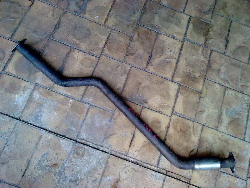

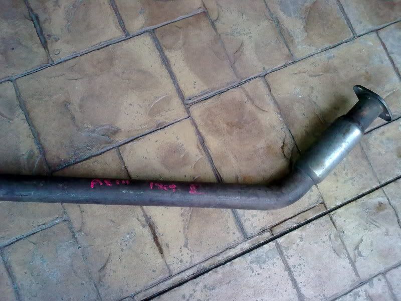

hihi, i m interested on ur pipe. how much lar? :-) i need to know how you measure the 2.38"?
I also having a whole set of levin piping, but i measure, it is not 2.38", maybe i don't know how to use or read those engineering ruler.
this is tough question bro... i try to answer.. if wrong dun shoot me...
1st.. the levin piping u need to find a portion tat completely round in order to get perfect diameter. some of our levin piping pipe is not completely round.. some portion is eclipse shape.. pls confirm this be4 do measuring...
about 2.38" .. actually is called 2 3/8".. which is not same 2.38"...
in term on metric measure will be more easy to u to understand..
1" = 25.4 mm
means 2 3/8" = ( 2 3/8)" x 25.4mm
= 60.325mm (so.. u can easy check by using normal ruler also ...)
hope u can understand this calculation and use correctly on tat vernier... thank
