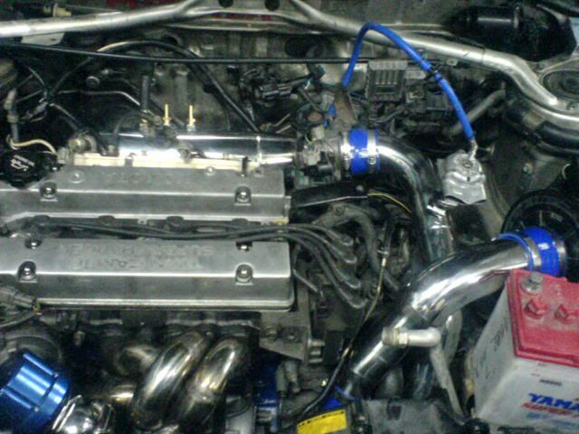

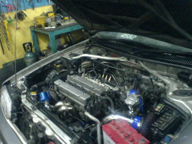

my boost is 0.9 now.
some mods i have made this week;
installed e-manage
blocked ABV
managed to outrun 20v SVT by 3 cars running 400 meters
fuel consumption is very good now after installing e-manage
ABV - Air Bypass Valve. Your mech shud know where is it. its like a UFO shape. Just block the air with a metal plate.
my fuel pump is from ae100. if u hve e-manage, no need to get external pump (if u wan, can also la). My boost is now 0.9, and if i didnt tune, at 6k rpm, i can feel the engine is lagging. i thought it was the fuel pump, but after tuning from 0 to 15 in emanage, rpm is smooth till 9k.
