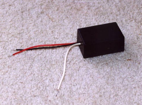

Problem located......fuel cut !! Installed a self made FCD...problem solved.

Green, mind sharing how you manage to pinpoint the problem? My problem came back recently...cut even at 0.2bar. From wht i understand, fuel cut is triggered when the car overboosts....but why do i get fuel cut at 0.2bar (your case 0.5bar)?
Hi ground zro, sorry for the late reply, was away, just came back. I copied the design from MR Controls...simple and cheap. I hope the attachment works.....happy diying...............

Thanks. Saw this somewhere in the web sometime ago but did not dare to try...since you have done it, I guess it is safe to try.
Thanks again.
