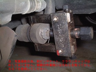

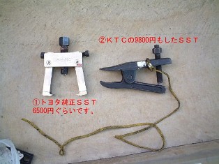

this is the special tools to open Super strut.....but i think work shop dont have this loo...
i think my mech only got this

i also only used same tools with u to open then joint. cham,,,,
others.. just used back traditionally ways,,. haha,. but need becarefull lo..

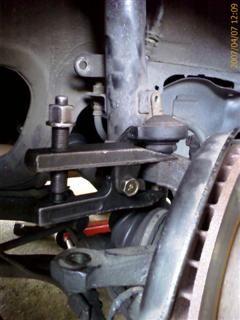

i think the black clamp is common tools which apply to all the suspension. only the mini M clamp is the special one. pls corrrect me if im wrong
Hey guys, guest what? I saw the 2nd tool but in smaller size at a hardware shop at Sunway. It is use to force push out a bearing up to 20mm size. The shop also carry larger size tool with 3 big jaws for pushing out A/C compressor's pulley. Both may be suitable to push out SS ball joint.
I will bring the SS there to find out which tool is most suitable.
The small one cost abt RM50, big one is closed to RM100. Both made in China.

i simply 8 to show of the tools for SS.... ahhahah
pic 0004 not so efficient to open tat joint... must use hammer on this joint...
pic 008 tools is very good for tat joint,..
