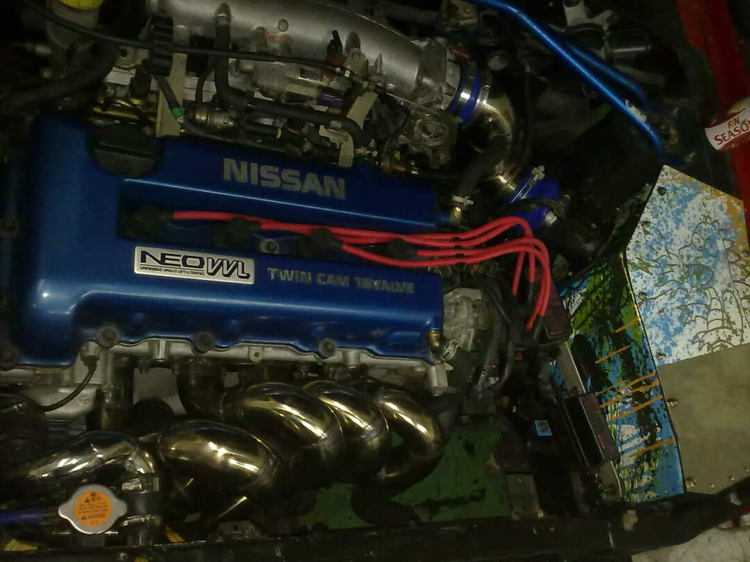

a pic of our neo sr16 on our time attack b13. smth to share.
custom made and took us some time to get it past the radiator fan. its a 4-1design and exit thru a side exit at the frt bumper.have yet tested it on the dyno but on our butt dyno engine rev up is smoother and very much more agressive onthe top whn first opening kicks in.

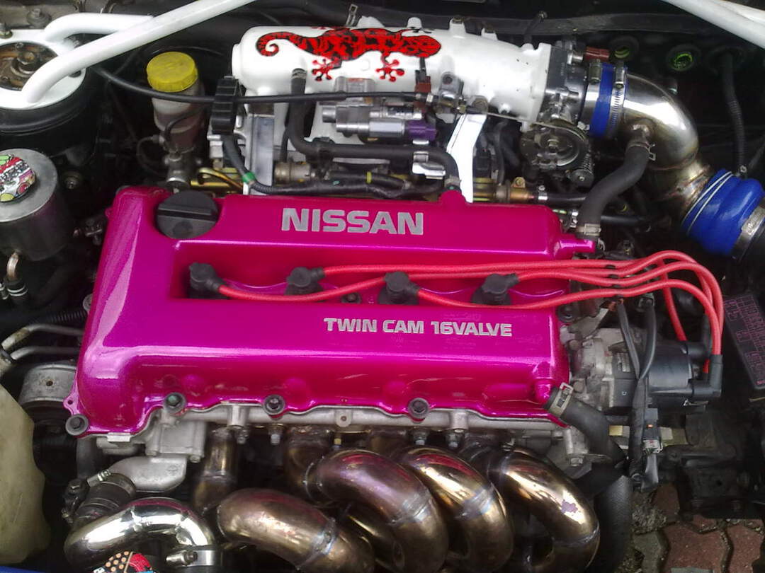

here's a closer look at the engine as it is currently, dun mind the gecko on the intake, it was a quiet day when one of the our "crative"staff decided to draw it so we tot it looked abit cool so we let the cicak stay.hehehe
