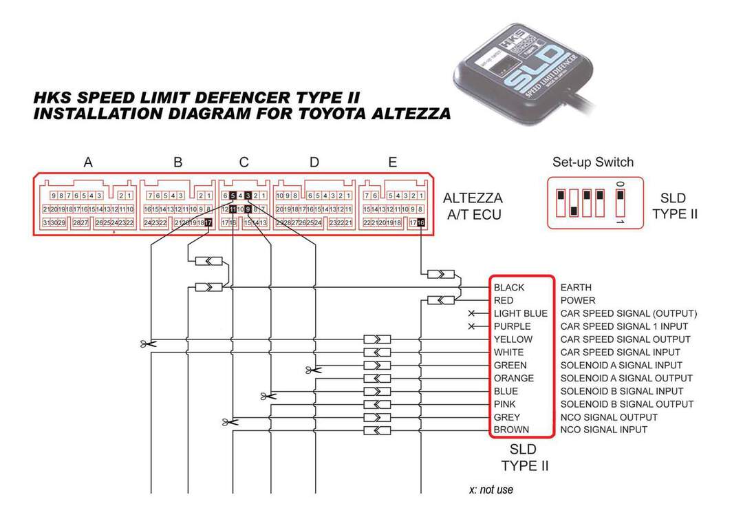

Hi..
anybody here have got the instruction. i search around but only found for other car. not for altezza.:banghead:
thanks

or..maybe if any of u have the SLD type II installed, can give me the snapshot of the ecu and SLD connection. need few more wires to connect.:hmmmm:
guys, there is a set back with sld type II,.....
the gear change from 4 to 5 will be much earlier about 1500rpm, but it remove the speed cut perfectly....but the problem can be resolved with emanage ultimate...by setting gear shift position.:burnout:
Mokh do share with me the installation manual if u able to get it...i will do the same....currently i'am stuck to identify which pintout of solenoid A and solenoid B:mad:.....

here come the full diagram for installation of HKS SLD Type II for our altezza.
thanks to members who help a lot in preparing the diagram and test it
this diagram for your reference only. use it on your own risks. btw, it tested already :proud:
hehe.
drive safe dude.. hehe.. :driver:
Yup!!!!! as tested..it's working fine,..... but need to re glue the original altezza door visor, it's cannot stand the speed...giving an annoying sound when some parts of the double sided tape start to break....
