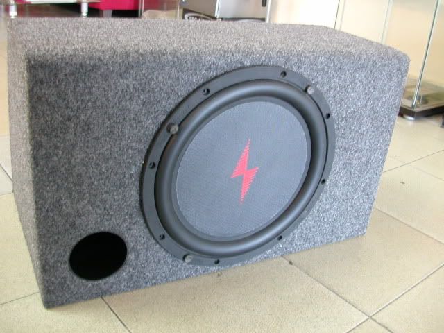

Woofer  : Precision Power PCS122

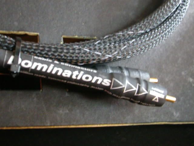

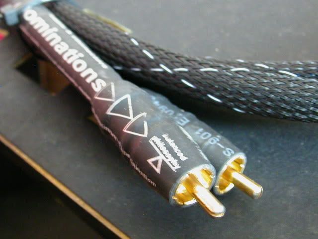

RCA Cable : Dominations

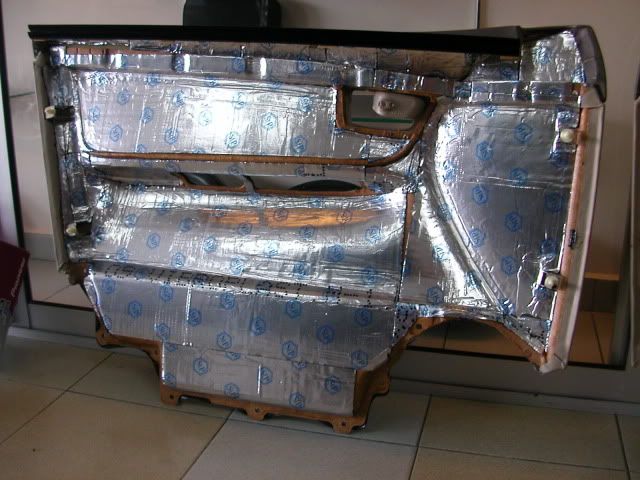

Soundproof : STP standarplast

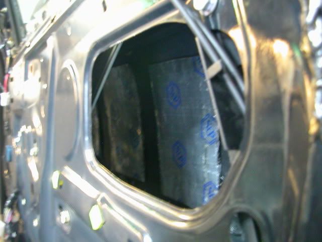

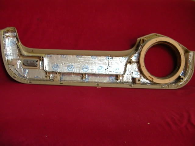

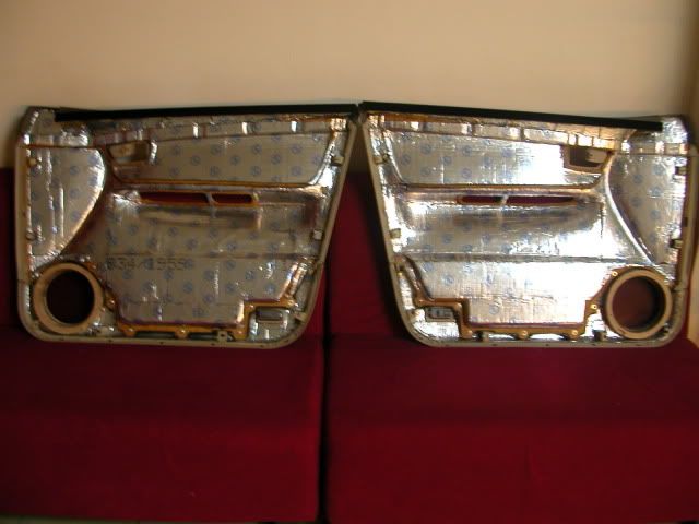

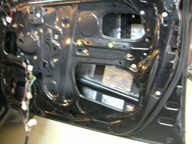

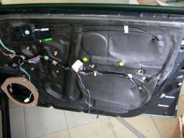

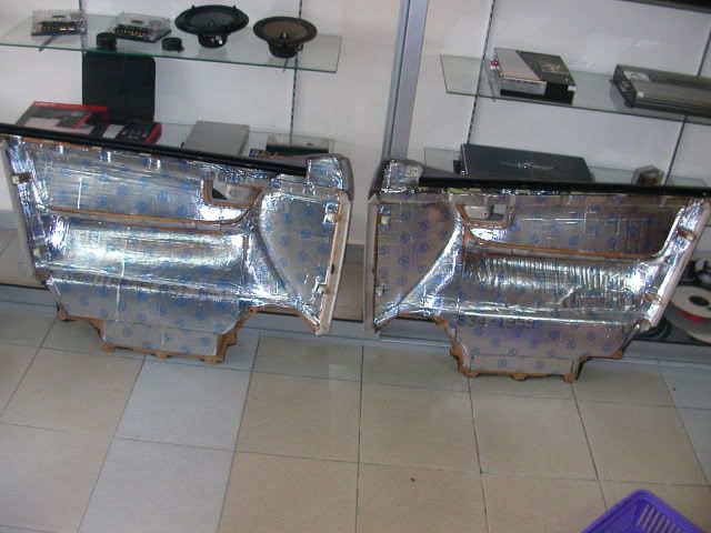

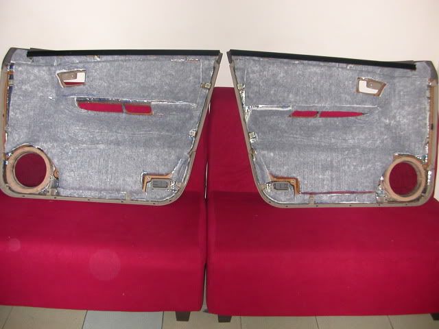

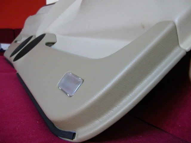

using STP BiMast series soundproof;

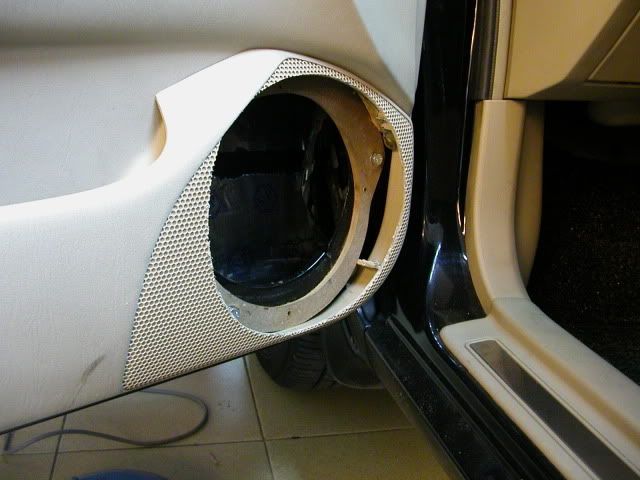

Reiforce door panel structure.Optimal effect is reached after 45-50% of the square is treated.
Using STP Visomat series soundproof, the door will be more solid and less vibrations.
Using STP Vibroplast series; Optimal effect is reached after 70-80% of the square is treated.

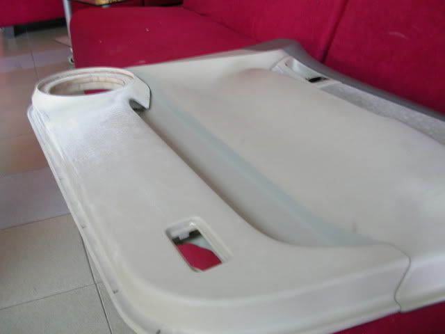

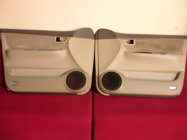

Before modify door panel

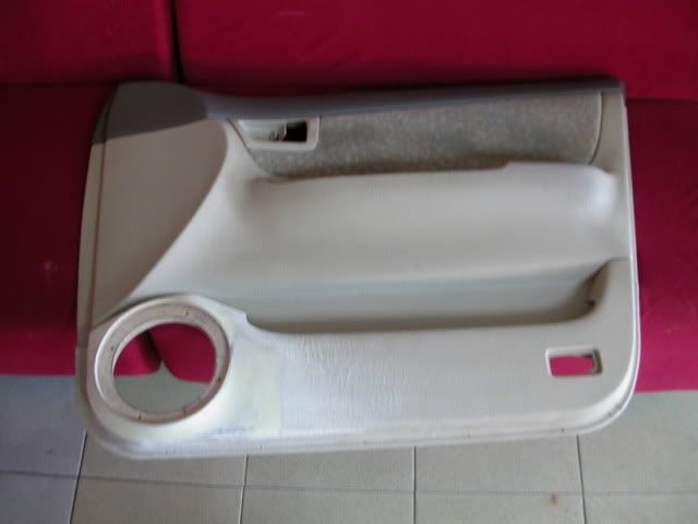

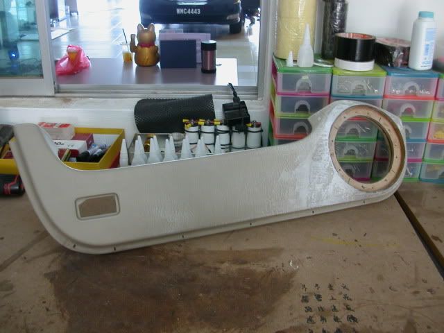

In the operation theater
After operation......:biggrin:

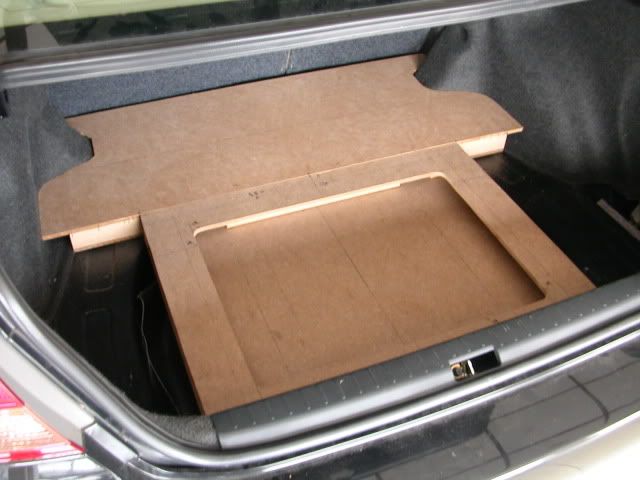

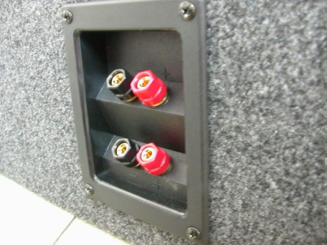

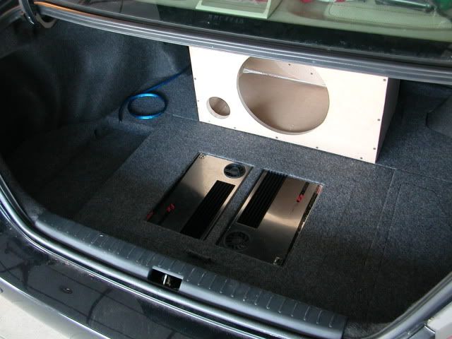

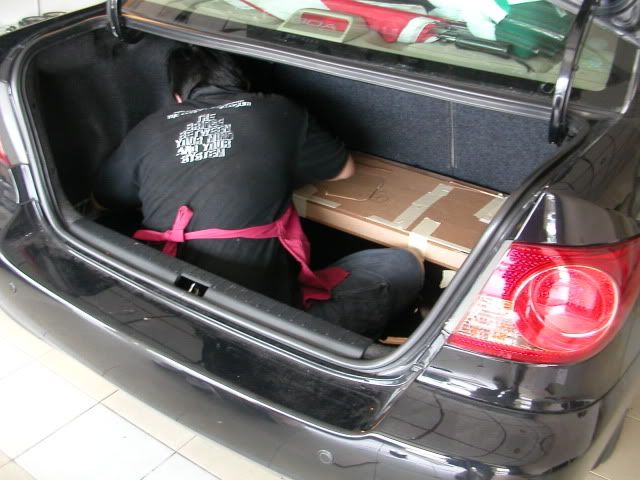

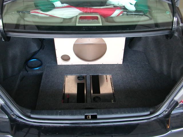

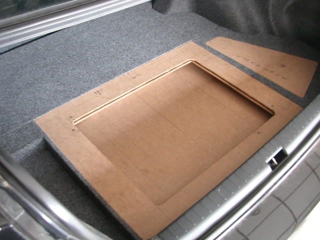

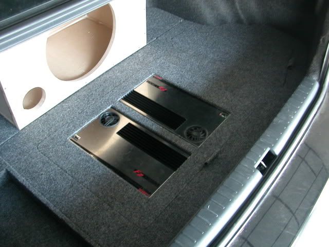

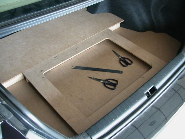

Trunk Modification

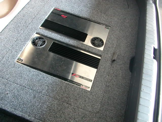

We put the amp under passanger seat

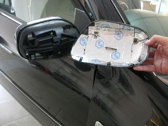

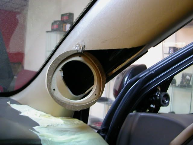

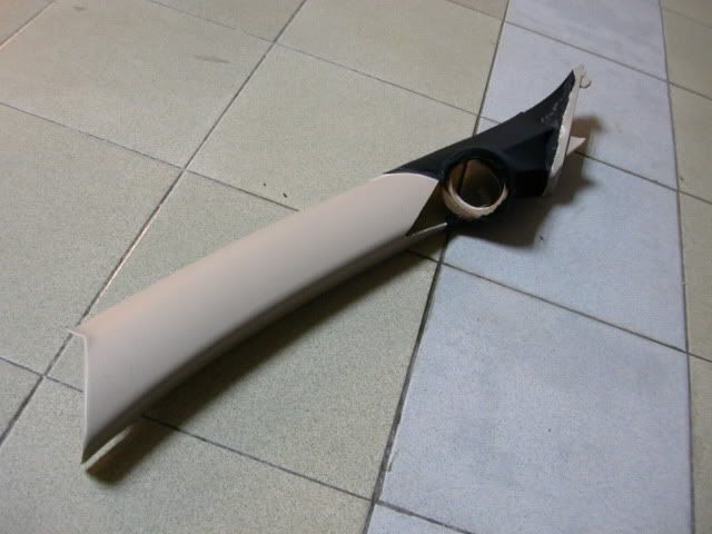

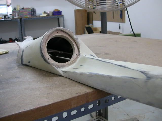

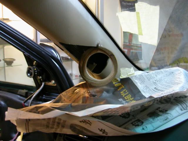

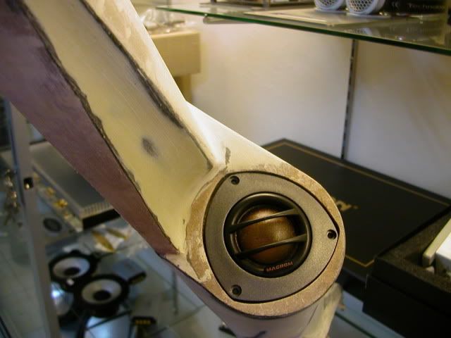

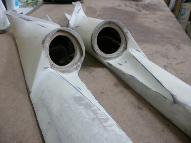

A-pillar modification
