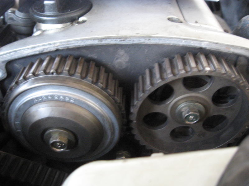

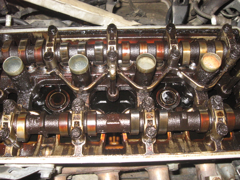

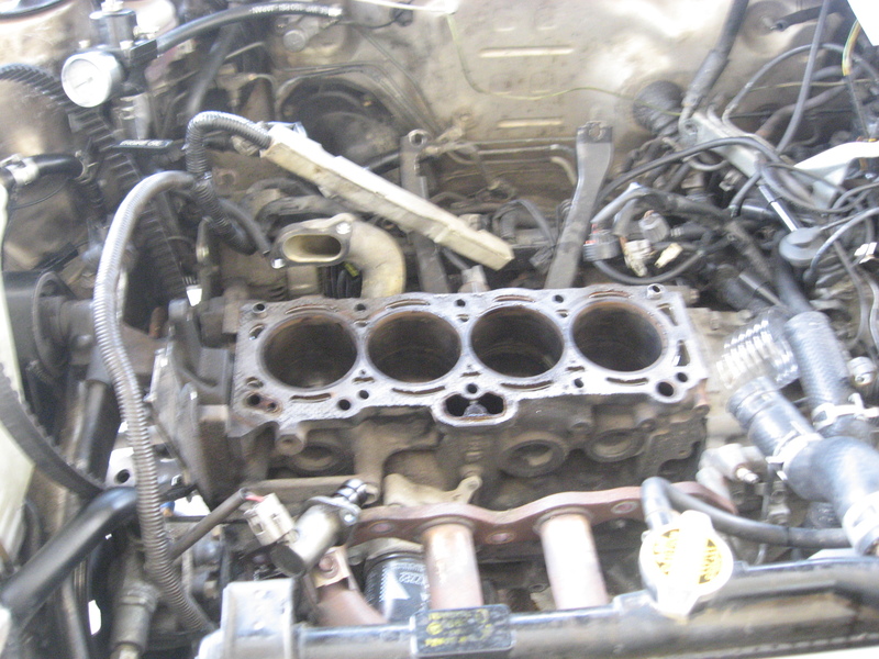

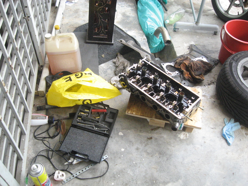

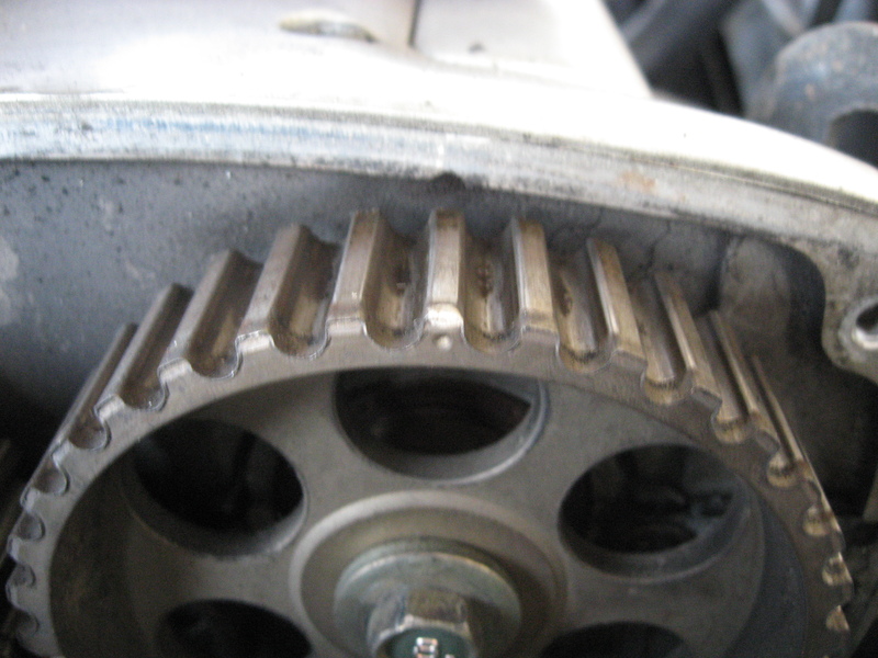

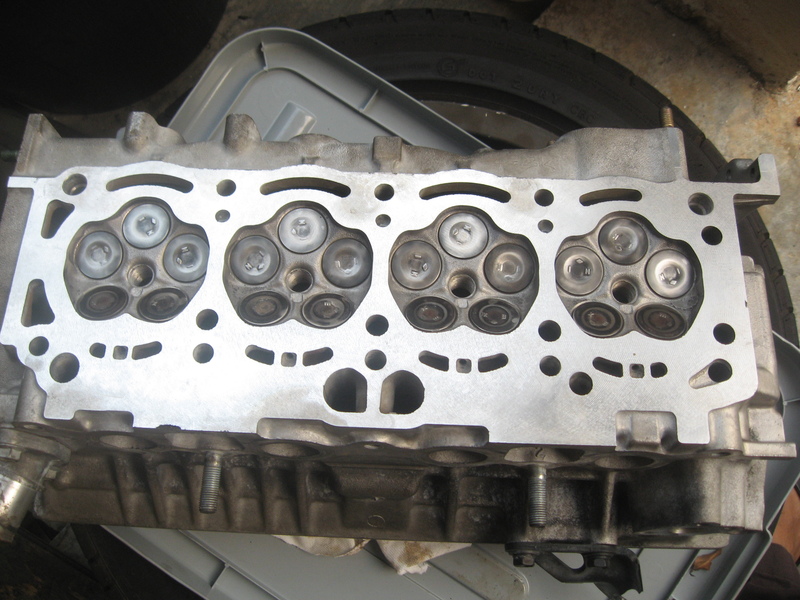

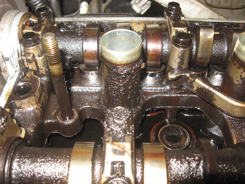

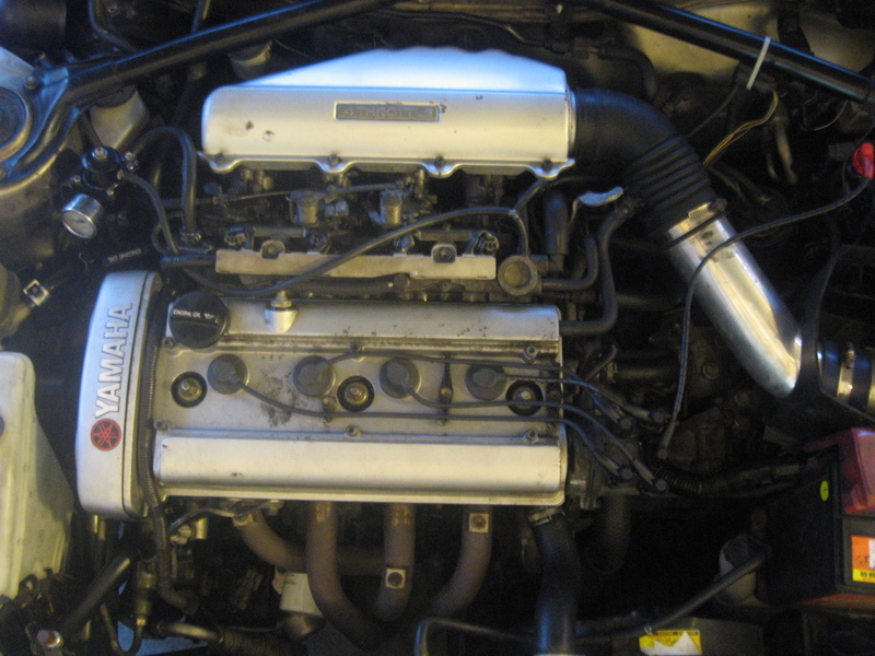

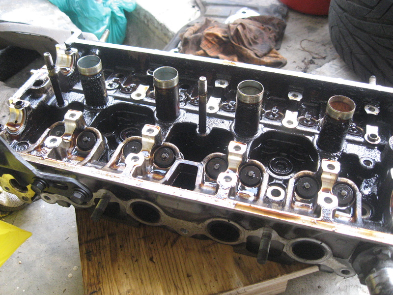

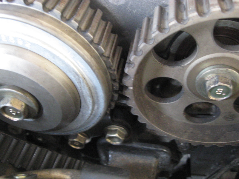

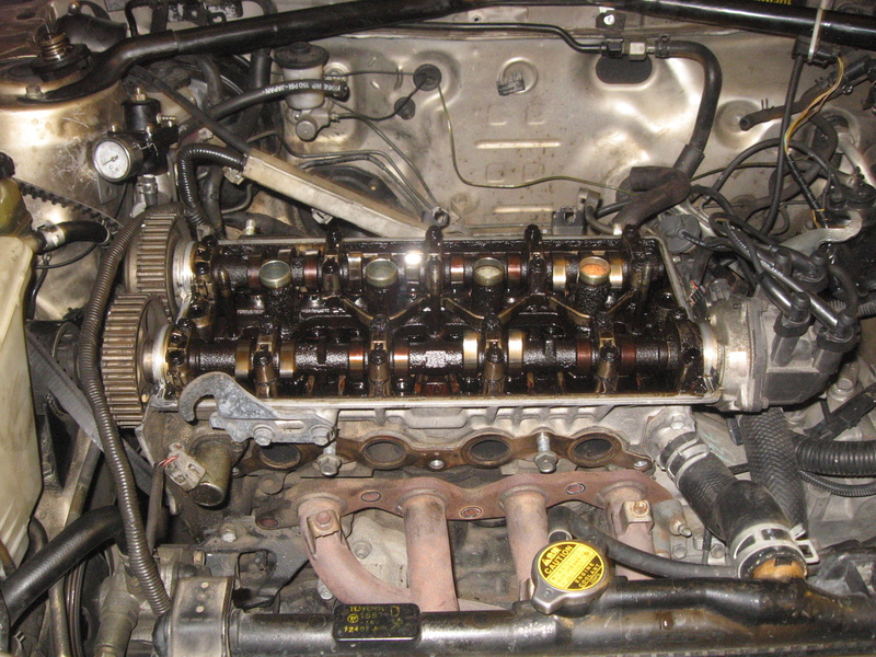

Hi guys,
I just want to share picture of my engine been overhauled by myself.
Please comment.....
P/s- I would like to thank for all members and sifu here for very informative thread.

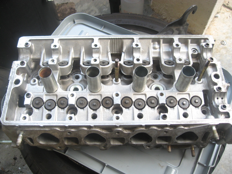

yes, did skim head a bit. just to make sure it is flat.
Head send to shop to chemical cleaning.

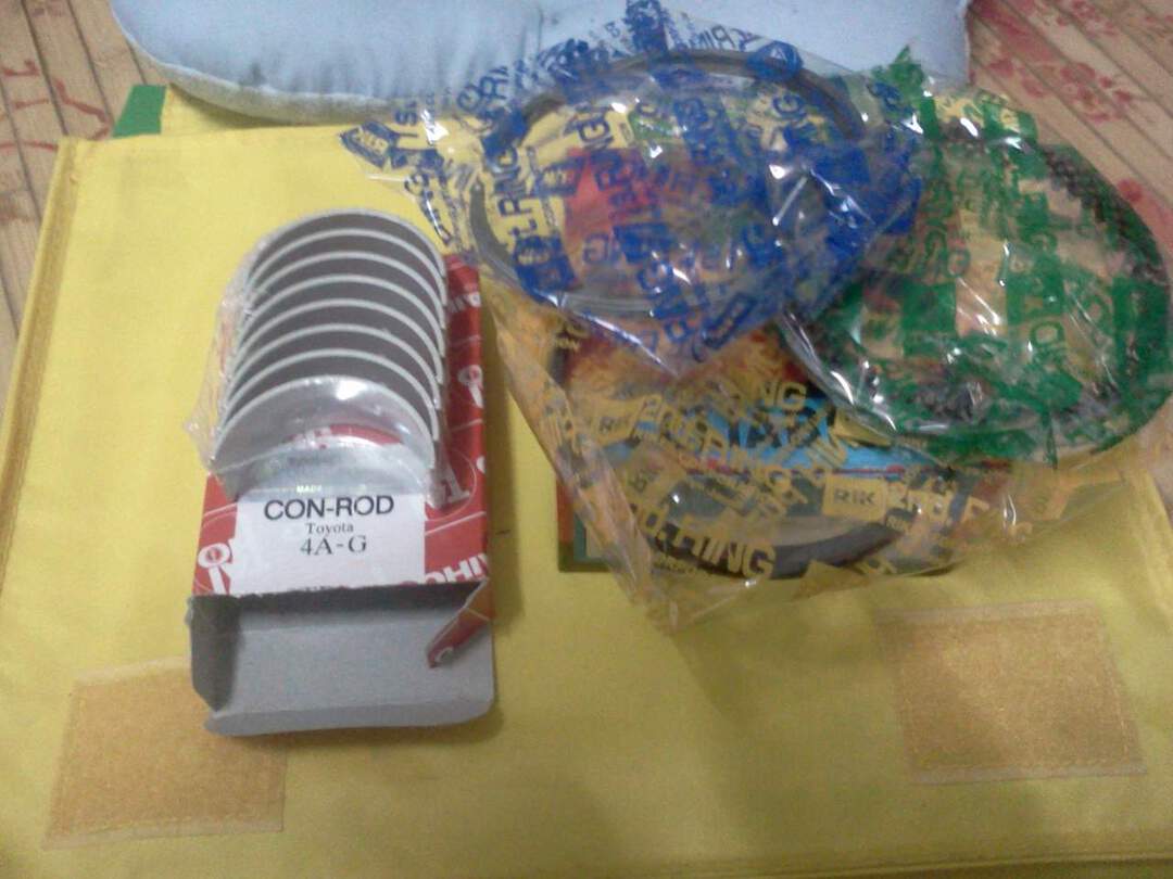

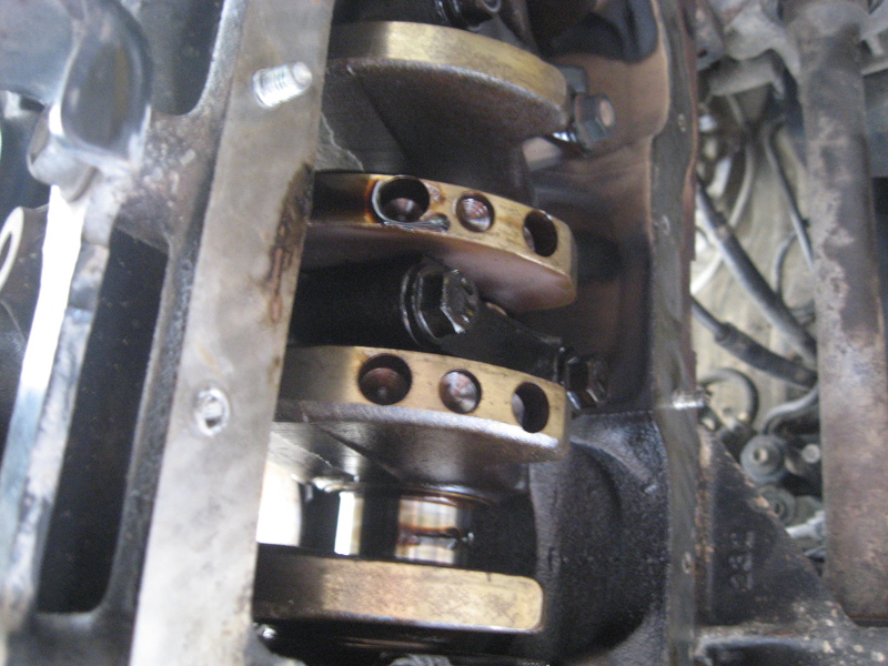

Piston ring and con rod bearing also changed. Forgot to upload picture up there.

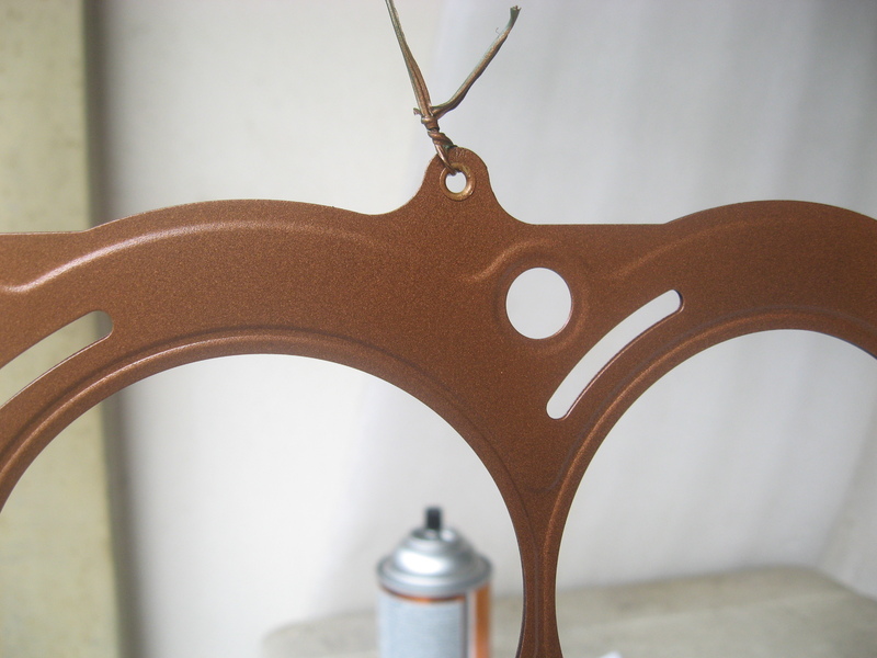

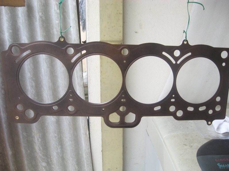

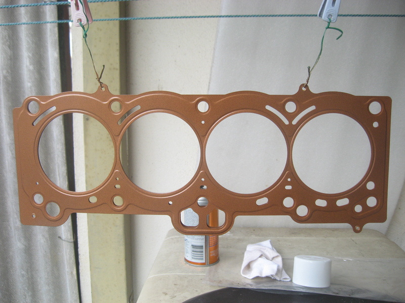

I have a ques. Is there any difference between the normal head gasket and TRD metal head gasket????

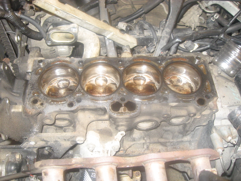

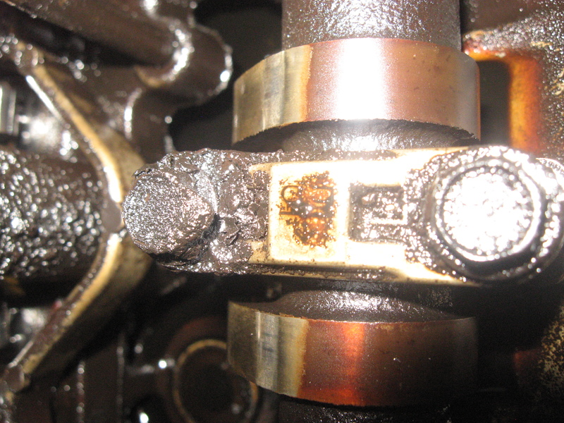

Anyways, looks like your 20v had some pretty serious problem with sludge. So it would have been best to drop the block as well and clean up the block, conrod as well as the crankshaft. With no power tools, I think its okay but you need to get a proper torque gauge as torquing down all the bolts according to the specs are crucial. Also, with the piston removed, did u check if there's any damage/scratches to the cylinder wall? Most importantly, the size of each cylinder with relation to the piston ring clearance.
Also, while at it you could have p&p the head as well ;)
However, looks like ur engine rebuild is already complete and hope everything is ok. Good job! Hope to TT again once ur free...
Thanks bro pcmod,
At bottom side not sludge as head area.
Already check the cylinder block-no scratch can be detected.
Torque wrench-also did search for it but no luck to find with low range torque. Minimum torque wrench which I found is 40 N-m while head bolt need 30 N-m.
Tak sempat PNP bro, need spare money to service absorber. Maybe next time PNP.
TT-also looking for that to. But not easy leaving home without bringing my assistant together. Cannot TT dengan senang if her arround.
bro...if it is no trouble for you...mind to share the cost breakdown for the replaced parts...and where to get them...thanks...
For the spare part, total is about rm900 not include ball joint and stabalizer link.
For tools, its about rm180. But half of them i dont use.
Nice job me2kimi :love:. May I know what made u decided to do the overhaul in the first place?
My engine suffer serious engine oil lost. I need to topup 1 liter in every 2 week. Also 2 cylinder already lost compression.
The engine running like 3 n half cylinder. Thats y I overhaul the engine.

Nice job there. Can share a bit ah? Do you use an engine manual? Are there a lot of electronics to disconnect? Have to remove block or not?
NO comments... Only respect :adore: Wish I had the money, tools, skill and balls to do what you did.
---------- Post added at 05:45 PM ---------- 6 hour anti-bump limit - Previous post was at 05:39 PM ----------
I see it is an AE111 :biggrin:
Yes bro, totally depend on the engine repair manual. It helps alot. On the electronic side, just need to remove 4-5 sensor and 4 injector connector.
I did not remove block coz dont have engine lifter. If I have that, sure I'll remove the block. :biggrin:
bro me2kimi, more technical info to complement these pics and this thread is screaming for a sticky!
Bro ragerunner, I donno how to explain about the technical, but like I said above, I think all 20 Valvers has the engine repair manual. I just print out the manual and make is as a book, open the book and refer it while working with the engine.
The manual is quite detail, it tell what connector to remove, how much screw to remove.
I can say that 85% came from engine repair manual, 10% from my courage n experience and another 5% is advice from friends and mech.
No need sticky la bro. I do not want to responsible if someone try DIY it and fail.Plus the picture is not detail enough.
