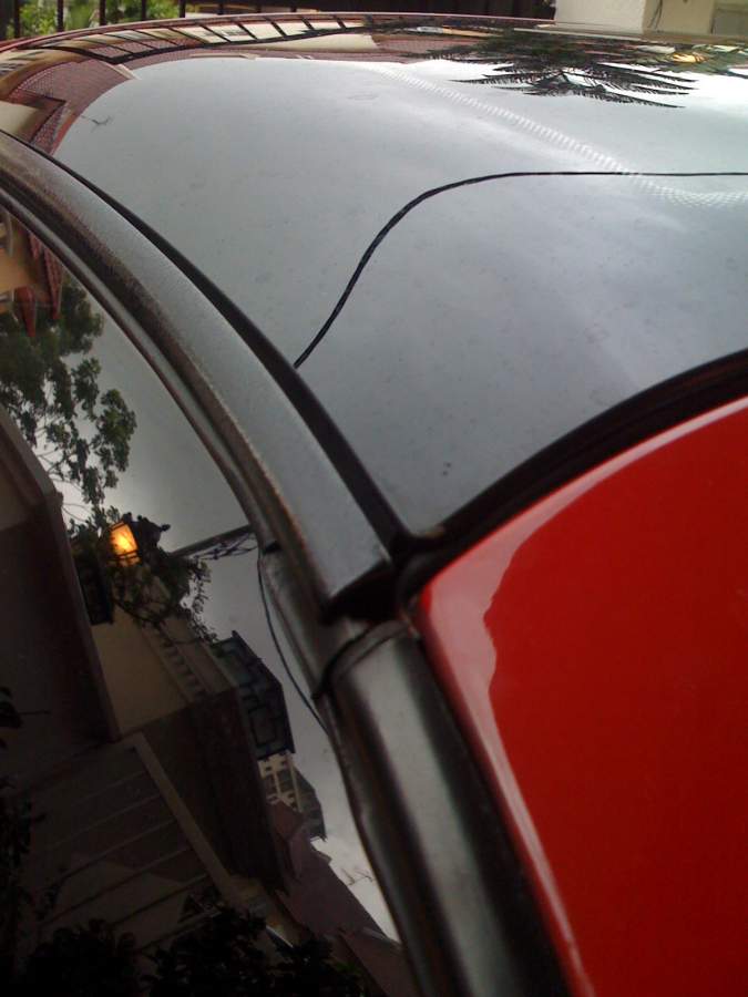

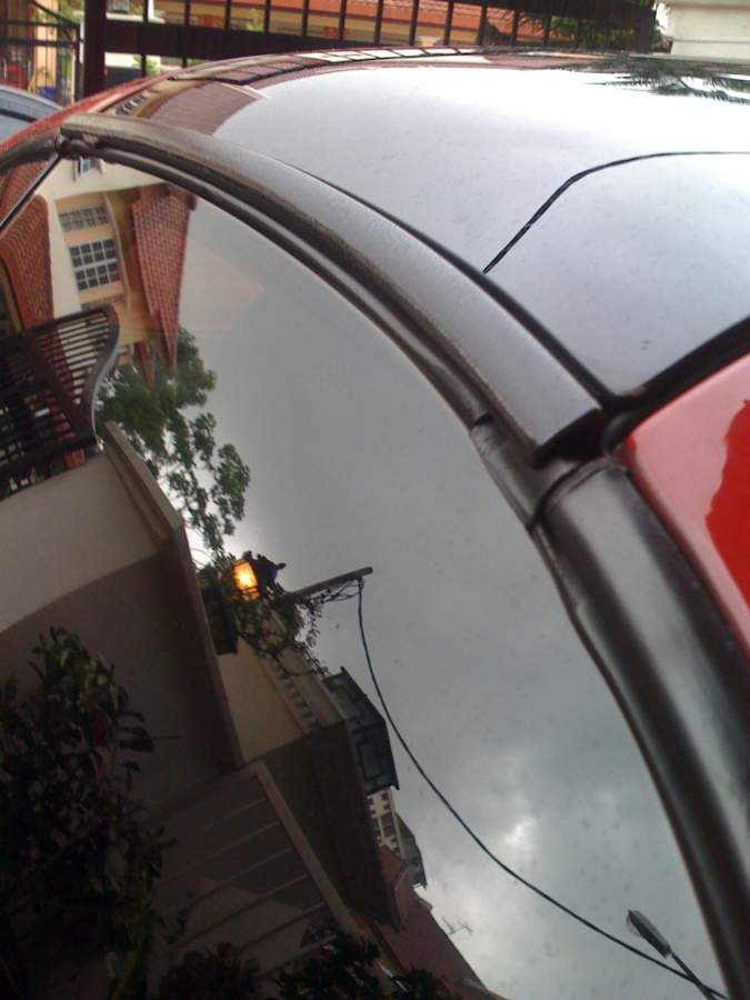

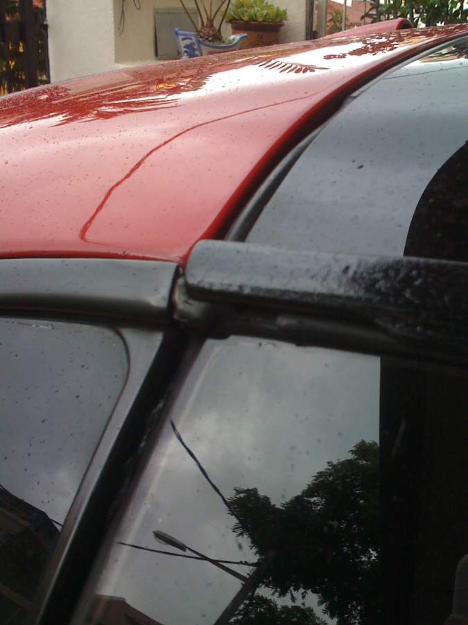

Bump: dear all sifu, just wonder if it possible to service the roof glass or not? Mine one i saw the part that join to the connector side of the car have a gap between the car body and the roof glass. Not sure can it be adjust to a closer fit to the car body or not...
It cause quite a loud wind sound when travel in higher speed leh...
tqtq...

vin, how come its popping out so much? or has it always been like that... (if it has then its very little only ma) i doubt you'll be able to change it very much. Buy another tagar top and try if you want (or better yet borrow form friend to try first). But basically the construction is such that you can't adjust it.
Be careful as changing it may result to leak. Even with new rubber some members experience leak.
new rubber experience leak?!?!?!? like that put on 2 rubber lo:rofl::rofl::rofl:
i've just went to the workshop that bro de blue recomended, the sifu there say can be adjust wor. So i will try to send my car to them next week and c how the result turn out later...
