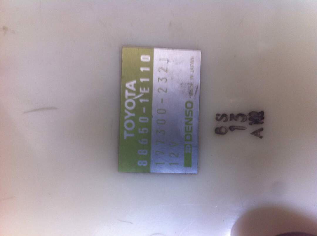

Ya only left with the ac control unit dint change, coz have mention before the correct model my forman don't have.
As he mention he only have the levin type model my should be wagon type which is the show in pic.
1 of the ac guy ask to modify the original thermostat to others to let it cut more often so that the compressor won't over heat but i dont want them to mess-up my original wiring.
