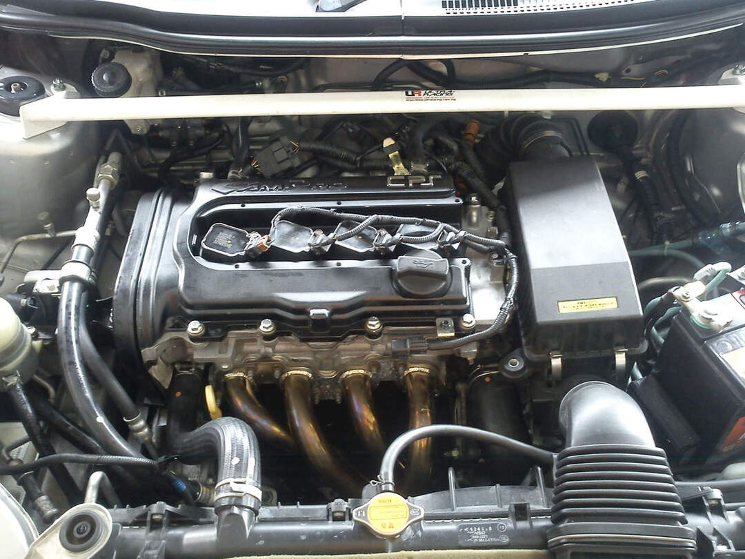

interested to see your ride bro.....hehehe
attachment.php
Done by Optima Autoworks, Pandan Indah.
