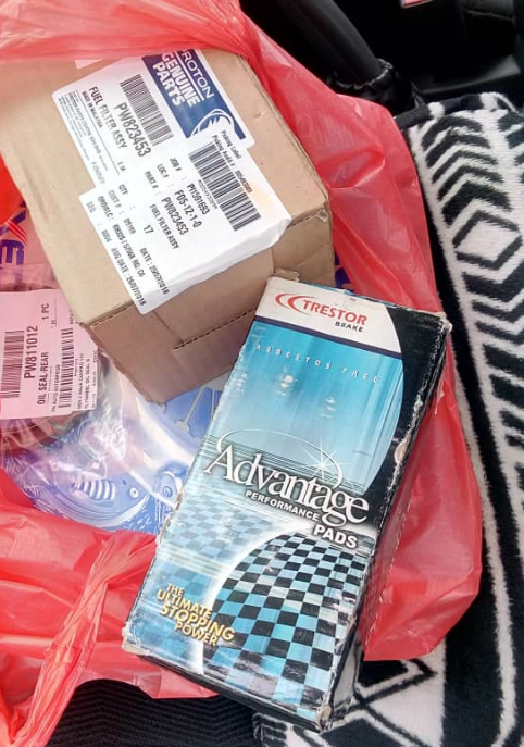

my favourite place. ahaha. but bay brothers dont have trestor..
