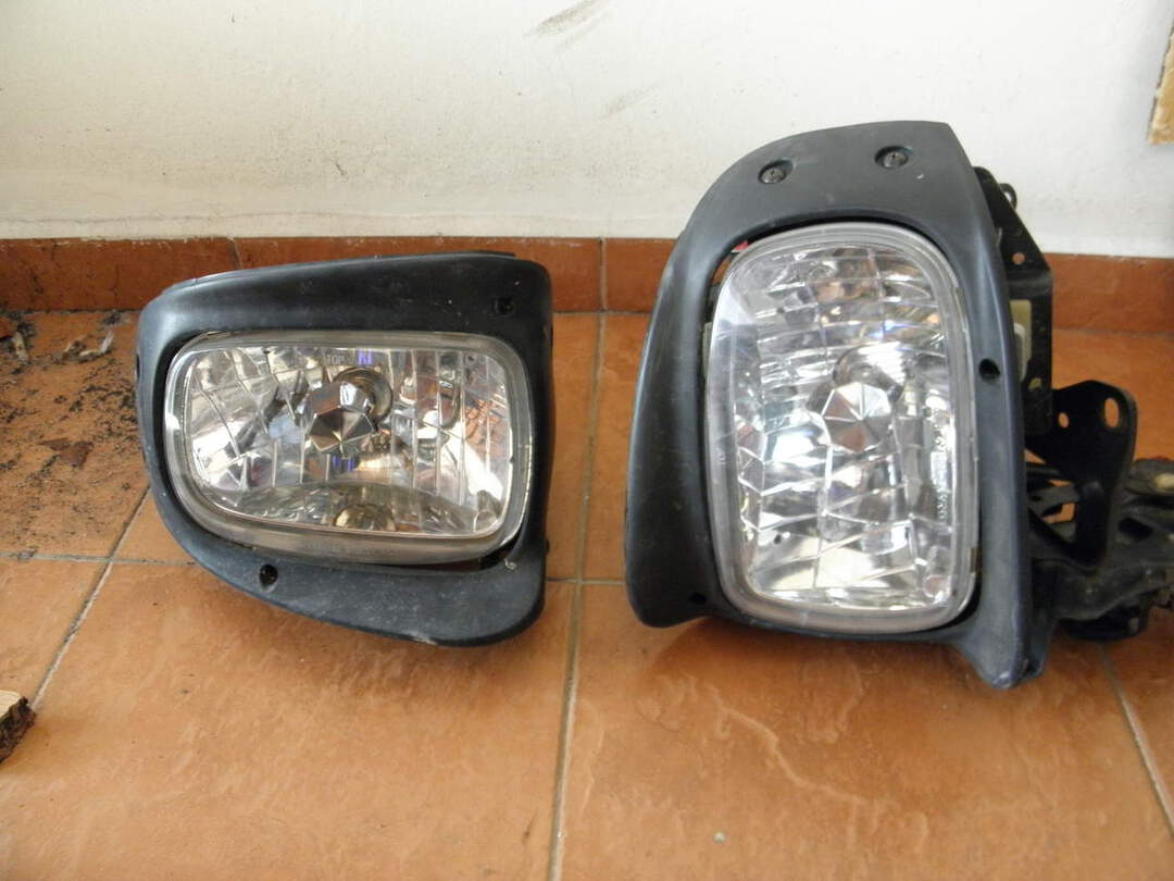

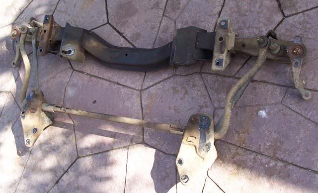

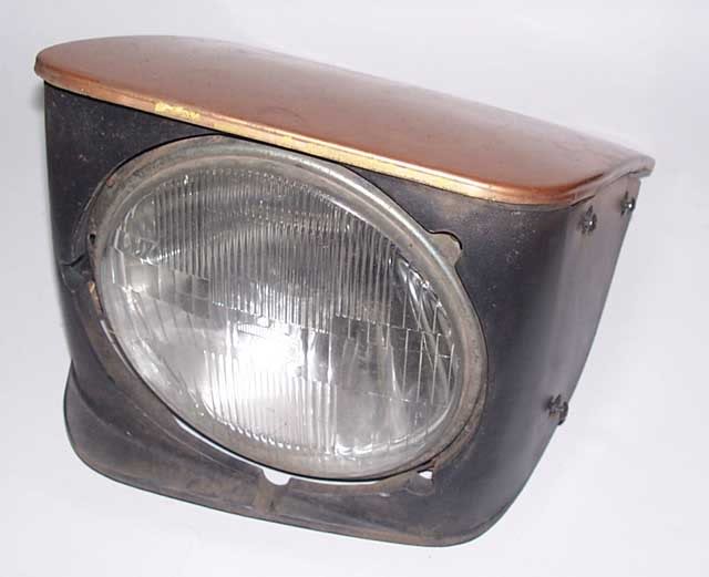

check the historical 1st series rx7 headlamp and how the modernization has make the later changes. and see how simple was the subframe in 1st series.
