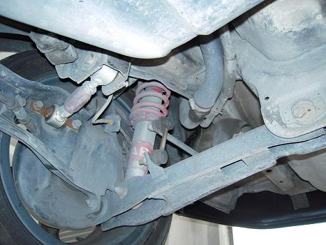

I changed the 2 dog bone connecting to rear trailing arm, the bush, fto rear lower arm & 16mm antiroll bar, GAB HA series suspension. i reinforce the chassis. now car jumping like rabbit. hehe, just wondering if it would be better to mod rear system.

care to share some pics of it??...
This is my rear suspension!
