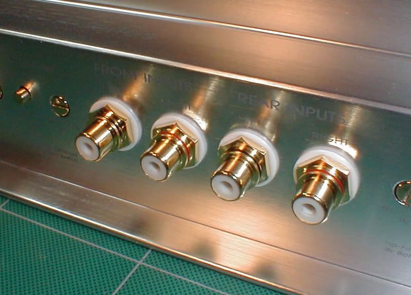

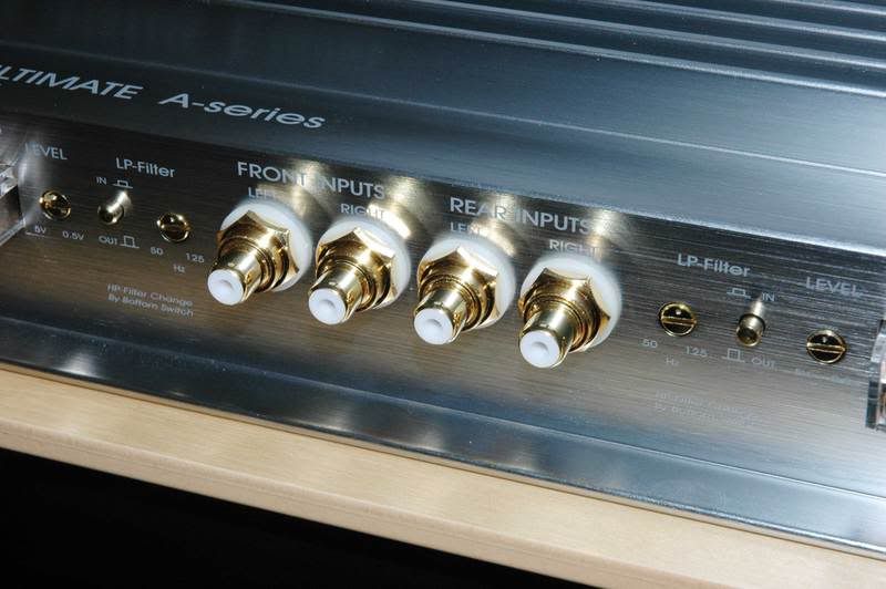

i dont think so, the fake A8 wasnt light. check the rca output ports, if got red and black lines its fake, ori one got no markings, both are same..

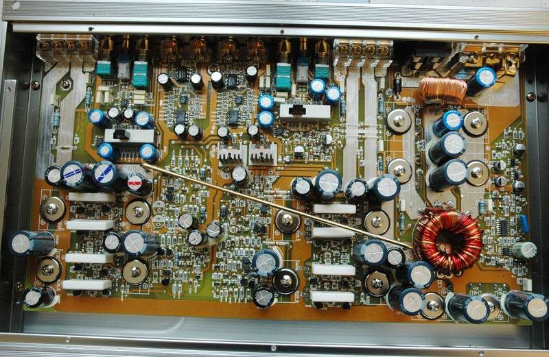

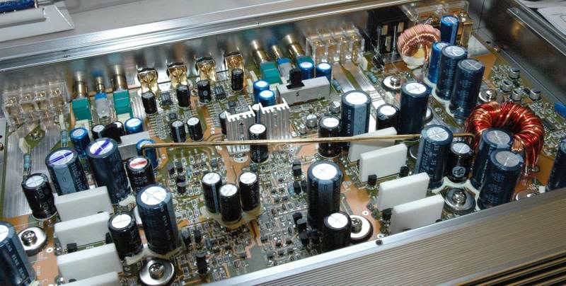

DLS A8
It is easy to see the big differences between original and copy if you look inside
Original
Imitation
Original
Imitation
RCA inputs w/o color rings
Original
RCA inputs with red and black plastic rings
Imitation
