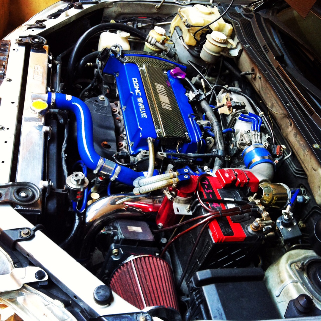

I had my stock radiator swapped out for an aluminium one October last year. I did that for 2 reasons. First is because my original fan controller is spoilt, even when I start on a cold morning, the fan wil be activated all the time. Then my stock radiator is due for change cos I can see that the plastic top looks brittle. I do not want it to burst during long journeys.

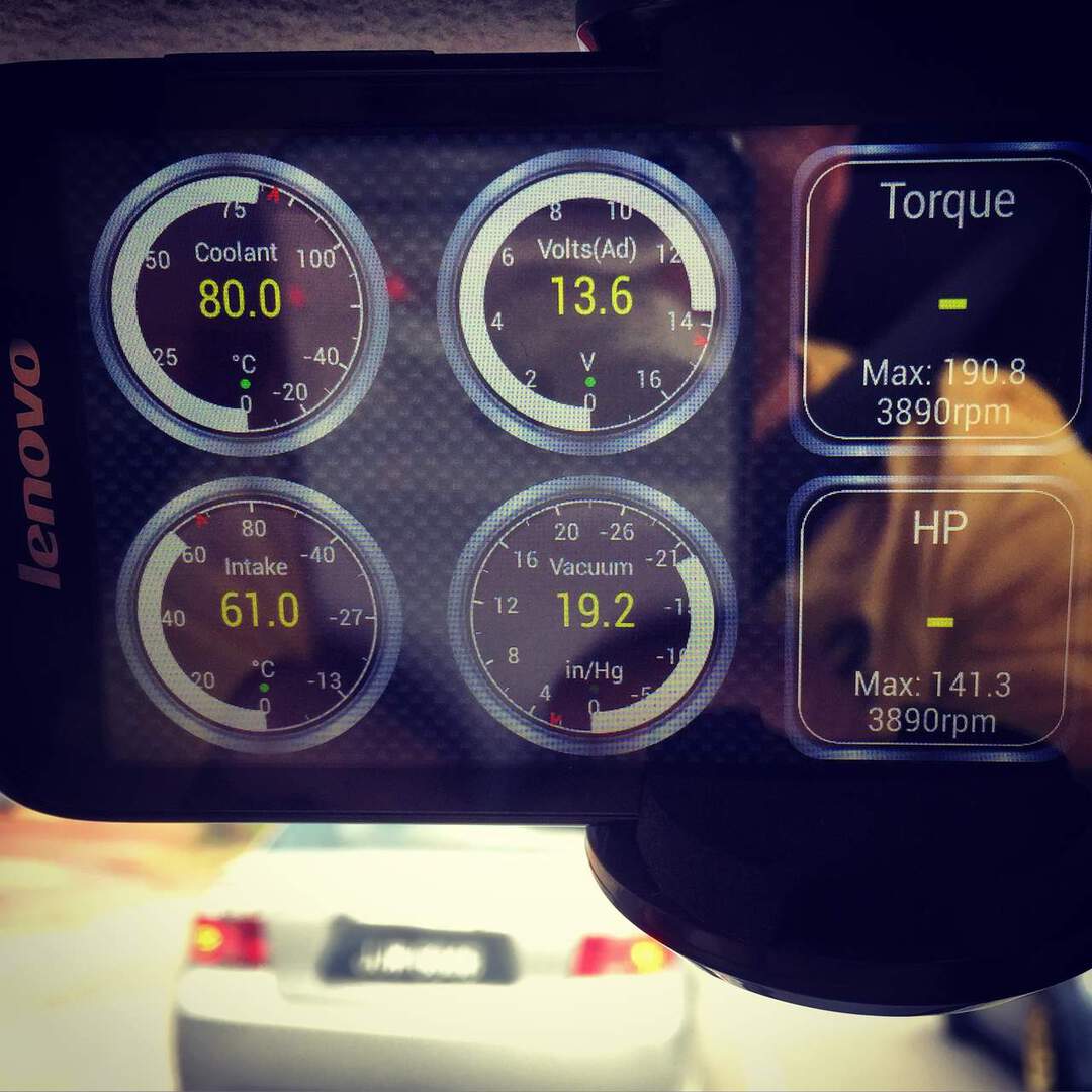

So the radiator is aluminium type + sensor driven fan controller. I have never really measured the temperature until last week when I got my son a new cellphone, I took his old one and bluetooth-connect with my OBDII reader (which I bought to check engine codes last time) and took a trip out of town. I was pretty impressed.
Observations
- On hot afternoons traffic jam, the highest water temp reached was 88c.
- On hot afternoons driving, it hovers around 77c-80c
- On cloudy afternoons driving, it hovers around 69c-76c
- On rainy days, it goes as low as 65c.
I think this mod is important especially those who is running bigger turbos and higher boost. Cooler engine will reduce pinging.
Intake temp however was high cos I am using open pods.
- On hot afternoon jams, 66c!
- On hot afternoon drivings, 45-55c.
- Rainly or cloudy afternoon drivings - 36c-45c.
I may need a Cold Air Intake I guess. I might also swap back my old airbox and test it.]
Hot afternoon traffic jam.

Sensor located on the cut-out of radiator pipe to drive the fan.

It's Airtrek specific. The aluminium radiator comes with oil cooling fins at the bottom too just like the original. However, the capacity is much bigger as it's thicker.
Air intake temperature is high but you got intercooler mah.......:biggrin:
even got intercooler still if heat soaked like sitting at traffic light/jams...the moment we need power to accelerate when the light turns green...it still pinging quite noticeable..since no air movement to cool the intercooler when sitting still...
Yup... so that's why it'll be good if there's water injector at the intercooler like stock Evo 8/9.
good stuff stutzedward,
as for the intake topic, i'll chip in with some facts,
our Renault Clio RS hits 70c with stock intake during traffic or at idle for a good few minutes. Hovers 60c at very slow traffic
No matter stock or now with a stainless downpipe located on the firewall side.
So i am unsure if it'll make much difference if you swap the stock box back,
do update us your findings
nice seeing the torque app being used properly. I only use it to clear errors at the mean time
