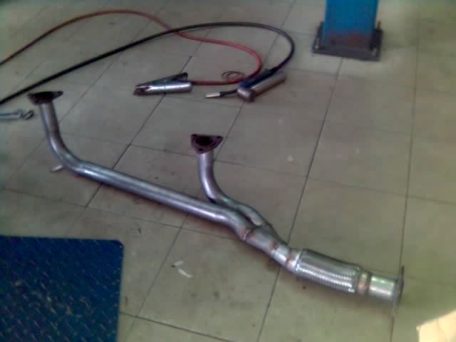

I have a A33 VQ20DE. Changed my Y-pipe and put a bullet to replace the center box. I noticed the surface of muffler is rusted and there might be a hole soon as it's getting much louder since the day i fixed the y-pipe.

i already took out d cat. can refer my thread. got pics there.

did mine at JFA with 2 flex pipe and 2 inch piping, cost me 480, which is a little expensive i felt.
i wanna mod y pipe too but they quote me rm300++ which is overbudget for me..

Try this link , you may find lots of info about y-pipe/s.:-
http://www.zerotohundred.com/newfor...71045-rm-180-for-a-custom-y-pipe-shocked.html

I doubt if u can just reconnect a similar diameter pipe. Most of us will remove the stock Y-pipe, and redo a new y-pipe. Exhaust shop will know what to do. After removing the cat, if u still want the silence, replace it with a bullet or high-flow cat.
