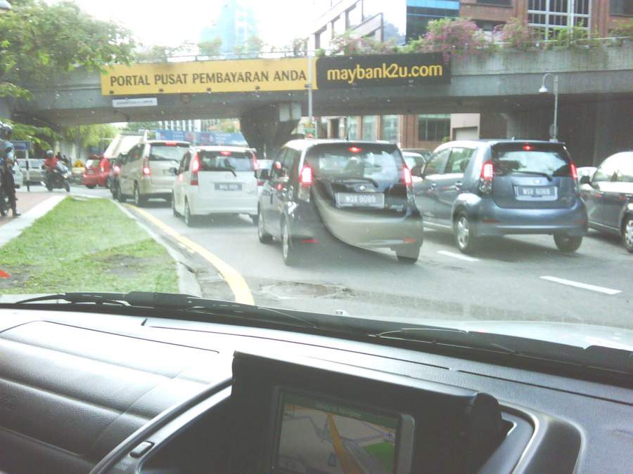

Bro, alternatively you could modify your existing Sat Nav console as a dummy unit. This is what I did to my car, I remove the screen portion of the Sat Nav and turn into a small box and fitted a Garmin portable GPS unit (Model 200W or similar dimension). You can rewire the USB power supply cable to your existing 12volt system.
Sorry about pic detail, was focusing on the traffic jam. :banghead:

altezza8448,
wow, nice satnav replacement !.. at least the motorized satnav housing is fully utilized!
been thinking to do the same...dou need to trimmed the satnav housing to fit the garmin dimension ? how u mount the garmin in there? double-sided tape ? .. interested to know more..
ya please tell us more, and where you did the replacement.
altezza8448,
Bro, use velcro tape for the housing and unit, so when I go kai-kai overseas can still bring along. :rofl:
Yup, just remove the screen portion only, then made a box out to replace the screen. No trimming required as the screen unit is actually bigger than the Garmin, the GPS unit actually quite slim. Did all this way back in 2007, at the famous car accessories shop in PJ (KK Lau).

Yup, thats correcto mondo bro. No major modification, just unscrew the screen and place in a box (made out of thin wood, painted black). All other functions (open/close/tilt) still operable.
Garmin unit is portable, looks like an Iphone (of course not so nice lah). So you operate the Garmin via touch screen. Just need to connect the USB power supply, which can be connected from your 12Volt system (behind you dashboard). The Garmin unit will turn on & off automatically once you turn on and off your engine. Make sure your Garmin unit is removable as you need to update the maps once in a while through you PC via internet.

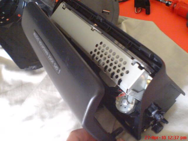

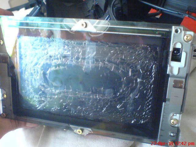

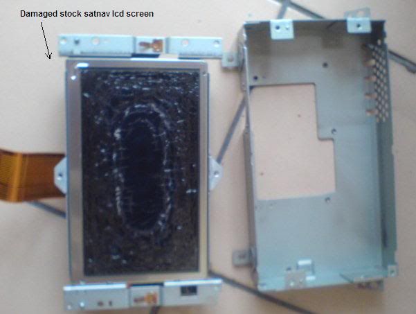

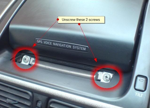

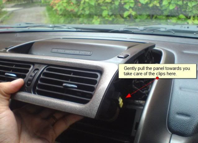

well.. actually just to share what i've done DIY in ripping out the stock satnav lcd screen recently..
notice this stock satnav lcd screen is damaged, maybe the car prev owner go punch the screen!?

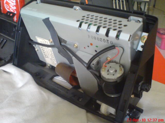

Basically what's holding the satnav, internal case, external case, are just screws ..
only 1~2 area is slide-clip-tab to hold it..
Managed to hook up the satnav motorized tray to
yet another DIY of mine (modding PSU to output 12v)
to test the open/close/tilt functions..

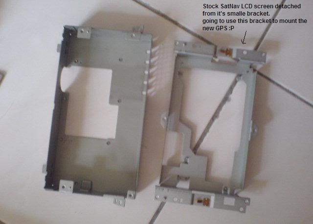

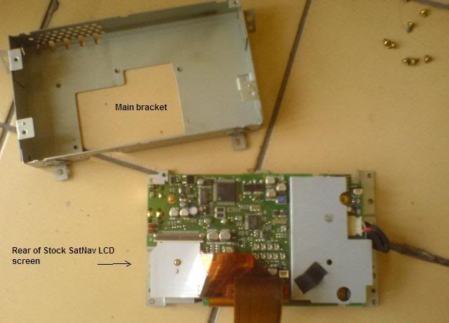

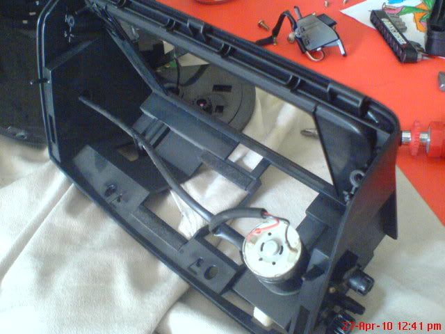

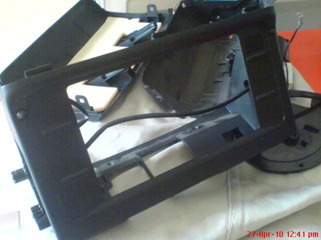

separated LCD brackets (main-bracket and sub-bracket) rear view.
separated LCD brackets (main-bracket and sub-bracket) front view.
yup, my LCD screen is dead. the surface is wrinkled.
going to use back these to mount the new GPS...
