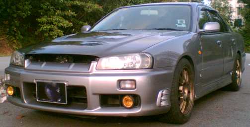

hey fellow zthian...i found a cf bonnet for my r34 sedan but they say is for 34GTR and should fit my sedan as its the same bonnet...Does anyone know if this is true is the 34GTR bonnet the same as 34GTT 4dR? any help appreciated
The only difference is that the BNR34 version has no "nose", i.e it's shorter overall as it does not have that curve up front as per the GTT.
Thus you'll get a gap between the hood and your bumper grill.
it will fit fine... i've fitted a CF hood on my 4dr ER34. No issues with the fitting, but you have to change the hood lock and the hinges to make it fit.
Yes you'll also have a gap in the front...
This is how it will look.....
