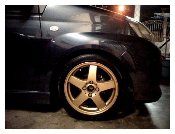

Hi guys.
Currently im using GAB sport springs for my car.
Gap between tyre and fender is as follow; Front = 2 fingers, Rear = 3 fingers
I wanna ask, is there any way to lower the REAR gap to match the FRONT? becoz now the car now is slightly 'tonggek'. not really noticable though..
I dont want to cut my springs or 'bakar' and compress the springs, as i heard this will shorten the spring lifespan and its not safe..
If i change my standard abs to short stroke abs, will it lower my car?
if possible i want to lower to 1 finger gap for front and rear..
Any suggestions guys? (except for changing to adjustable.. budget constrain la haha)
