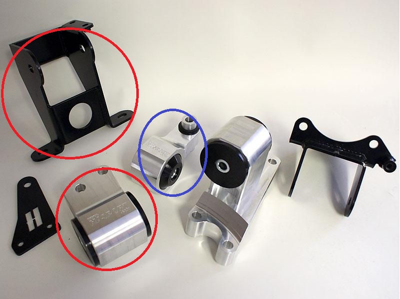

Power steering rack was swapped whole set FD2 electronic power steering, should not power steering rack issue. My pomen go buy FD2R cap ayam Hasport mounting set and use only this one that I circle red color on the photo below. That blue circle more worst, not over 3 months already make steel sound knocking damn noisy that I thought my welded exhaust air leak. Any idea to replace another brand mounting to not let my steering jerk?
that's a full rubber solid mount. of coz you'll feel slight vibration on idling at stationary. you're lucky only the steering is vibrating and not the whole dashboard. just go buy stock fd2 mount and replace it or get what @Izso suggested. confirm no more vibration after that.

Bro.. solid mounting sure la. Vibration not absorbed by the rubber and transferred to the chassis. The only option you have is to live with it or change to a softer mounting type. Perhaps the ori Hasport mounting is better? Or see if you can find the innovative one.

Actually after I replaced both mounting I circled not over 3 months, whole dashboard is shaking and cause steel knocking sound then I replace bottom mounting (blue circle) to original rubber type.

Correct me if wrong, if you are using mixture of solid mount and normal mount, won't the normal mount give way first as it takes all the punishment....
