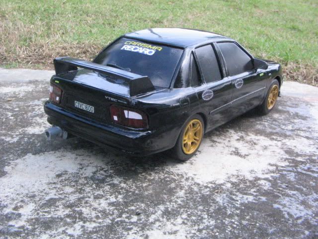

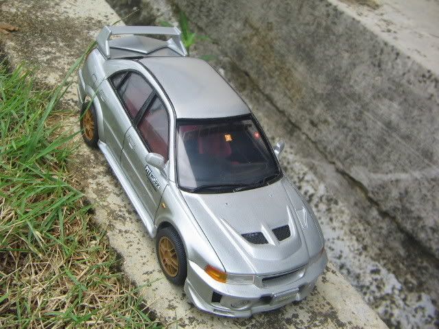

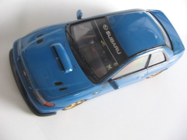

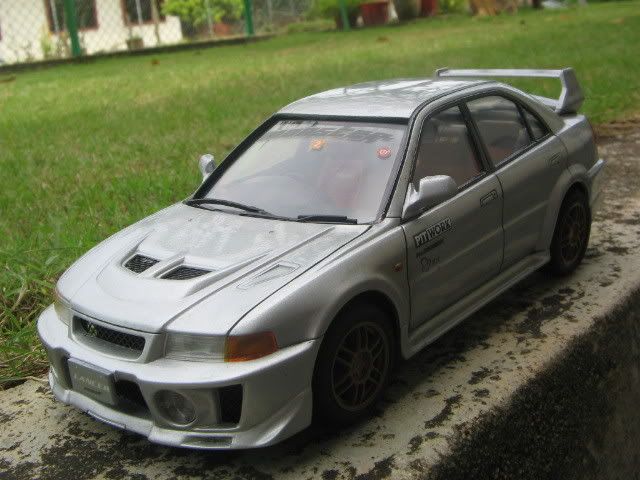

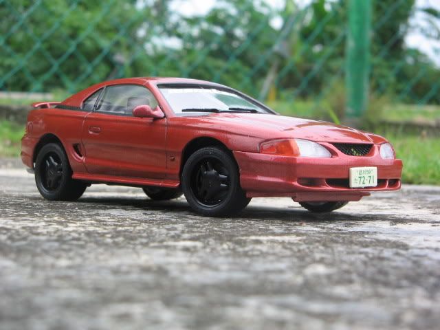

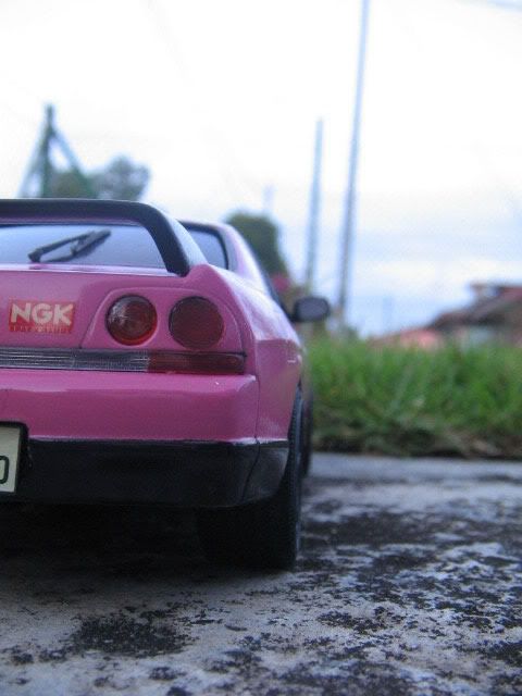

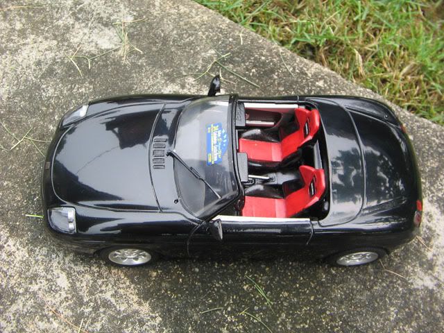

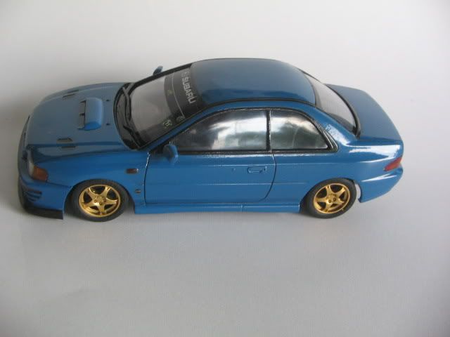

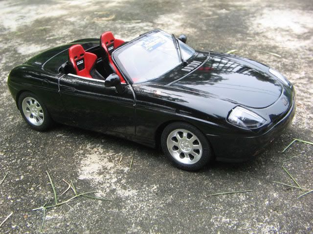

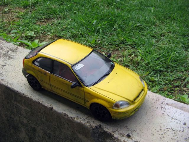

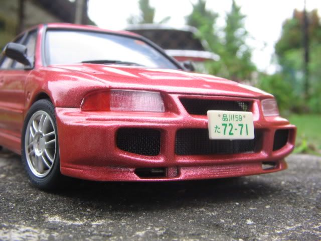

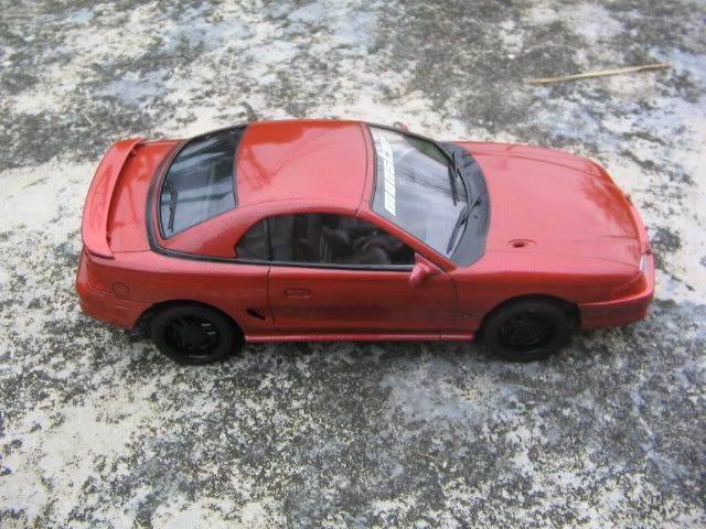

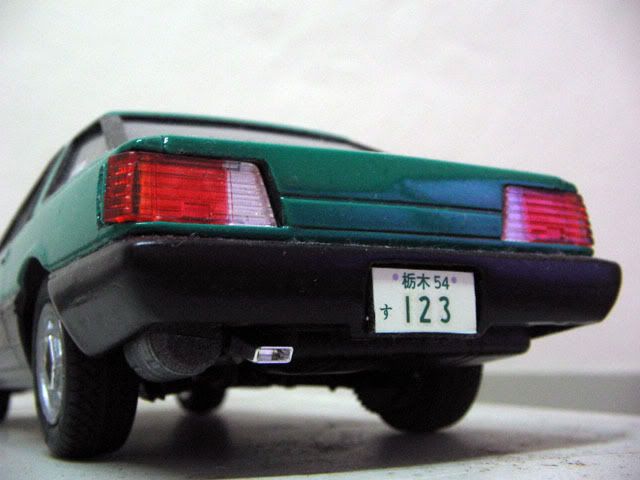

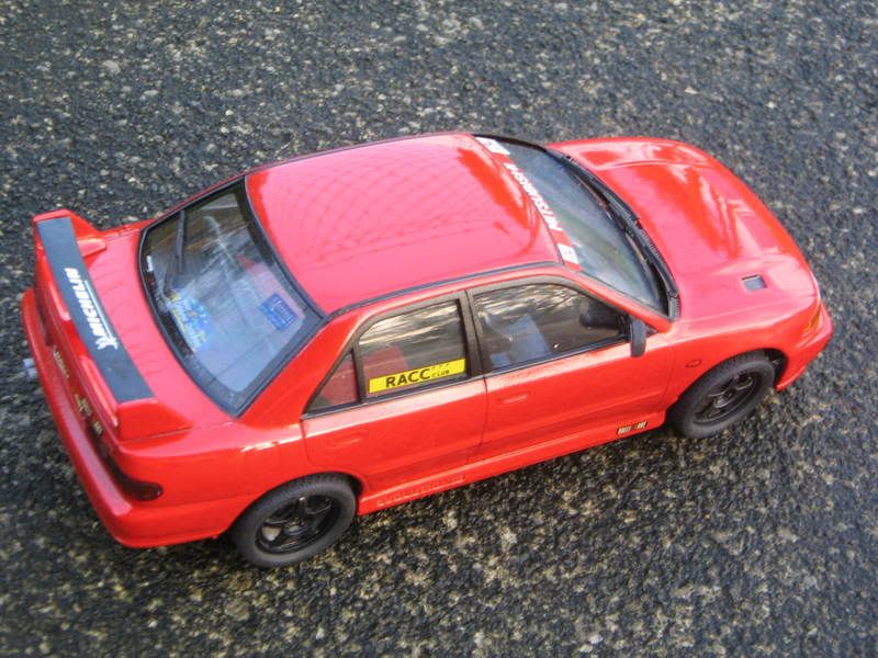

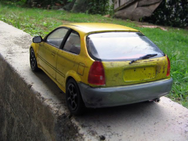

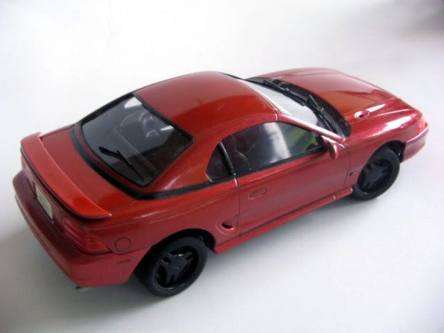

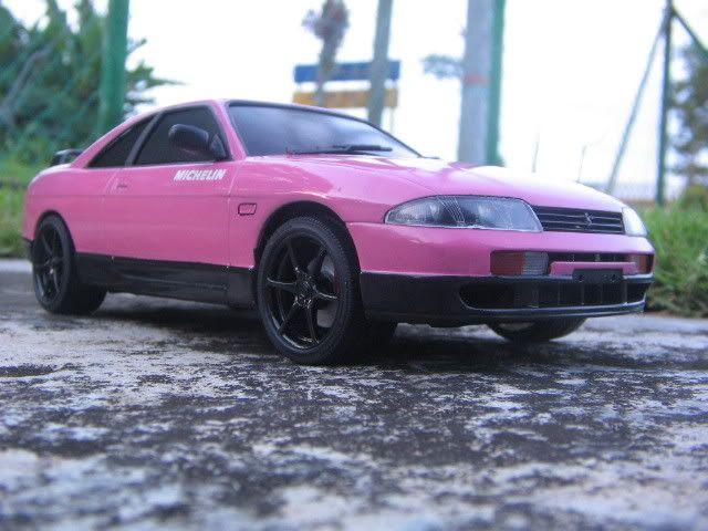

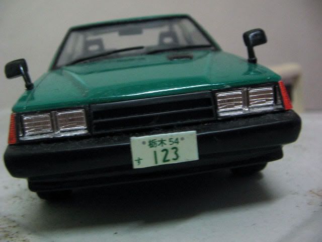

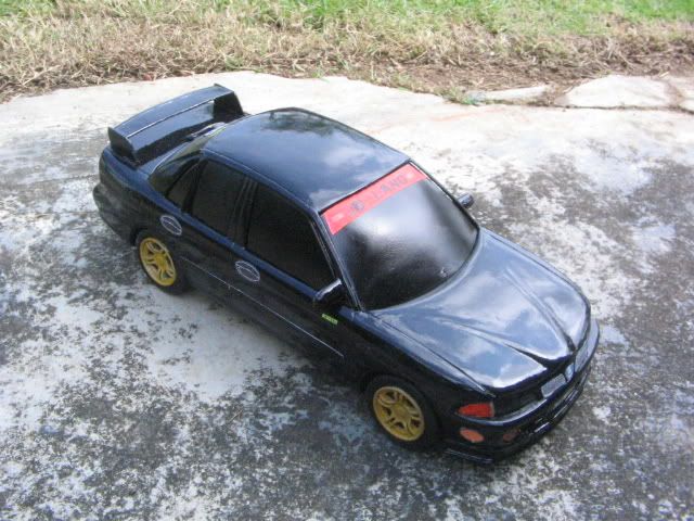

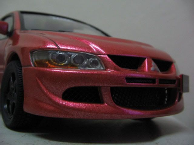

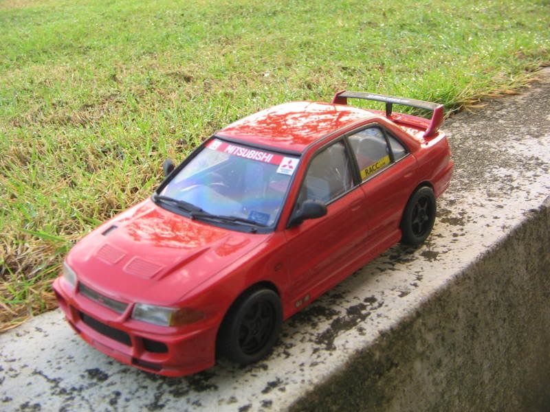

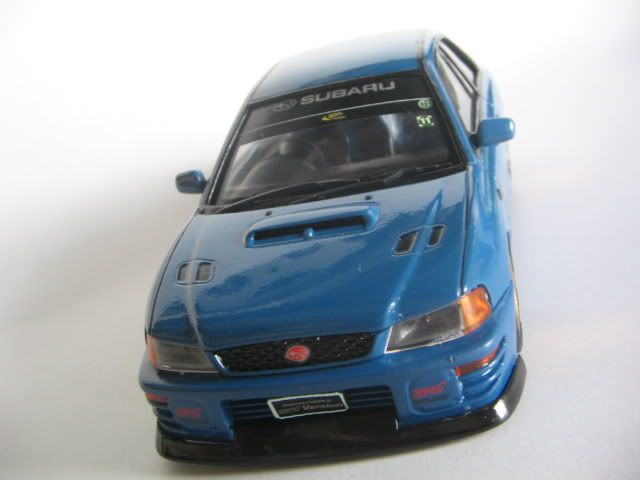

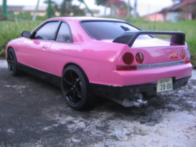

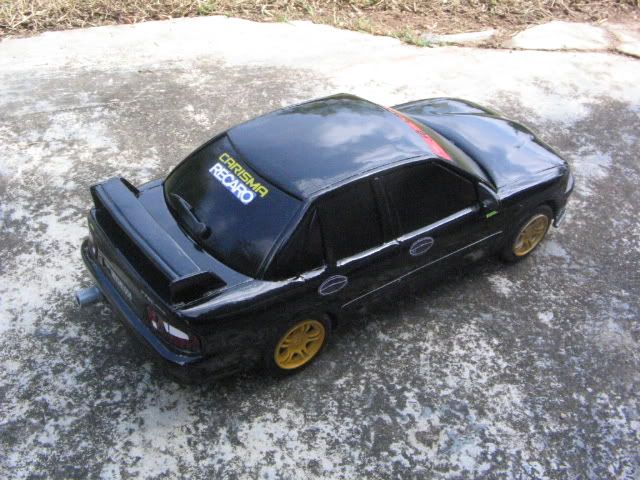

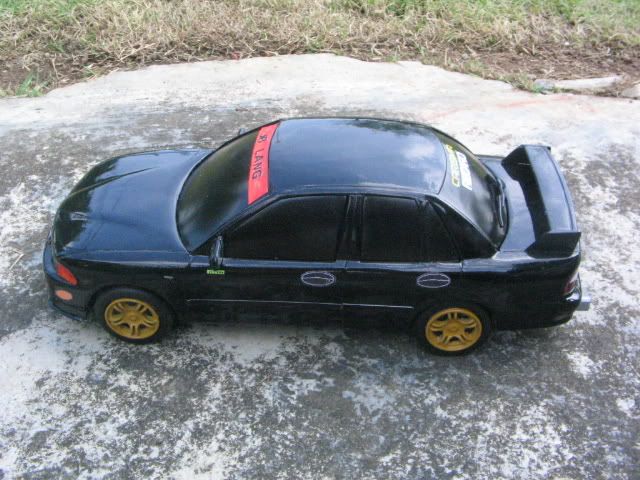

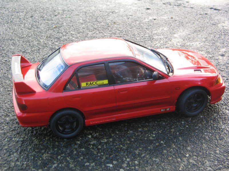

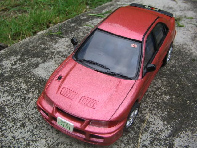

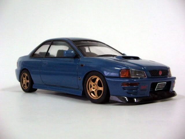

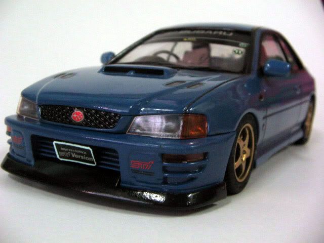

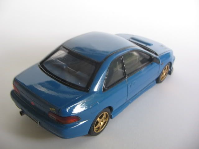

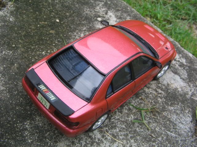

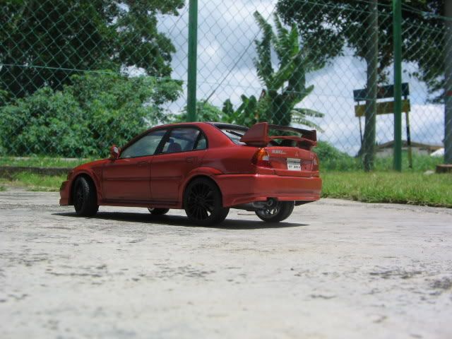

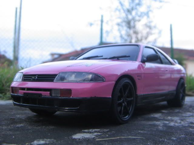

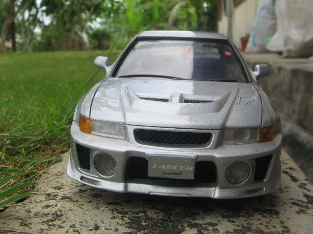

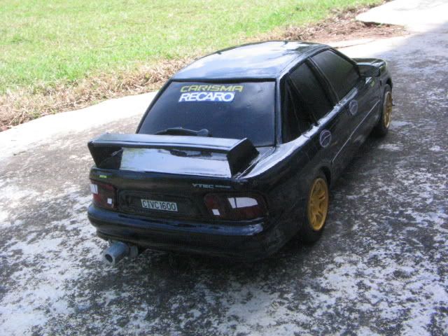

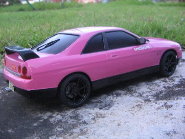

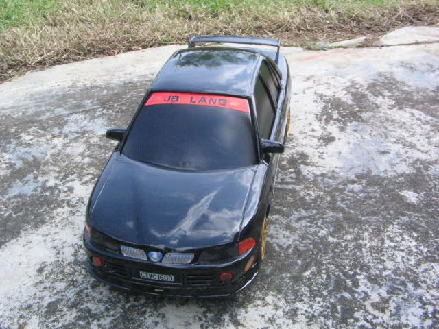

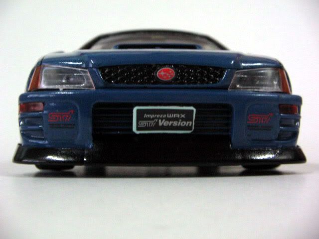

I build models for about a year and i love this hobby very much..

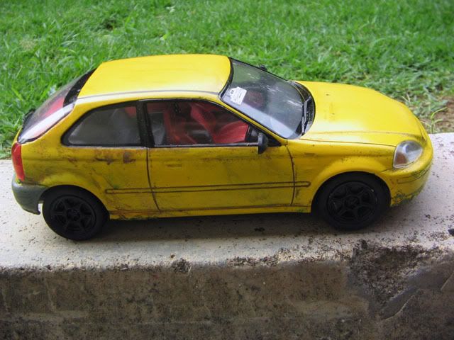

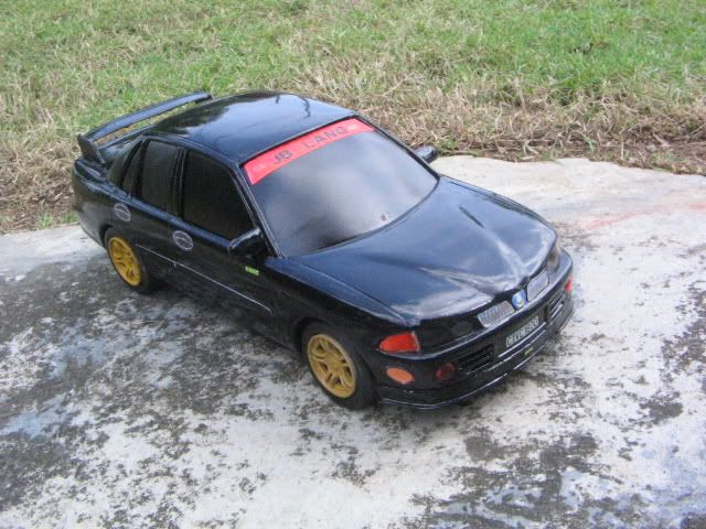

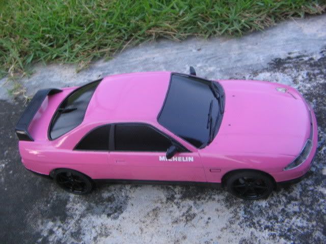

Here are some photos of the models i build...
Let the photos do the talking ok?

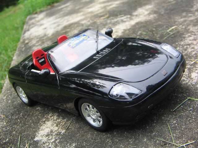

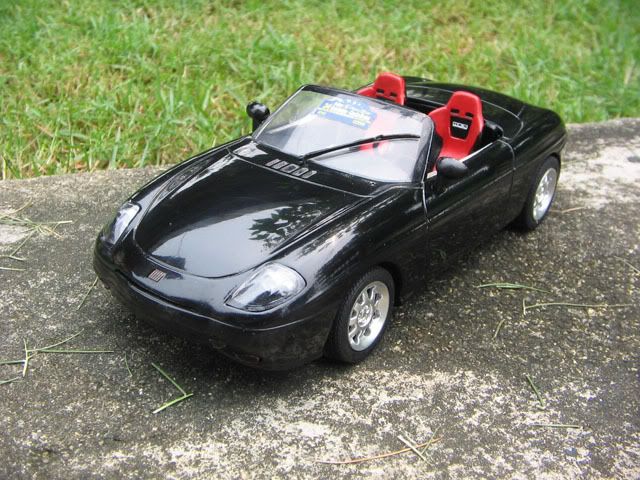

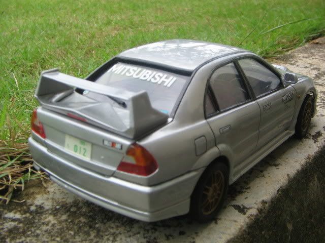

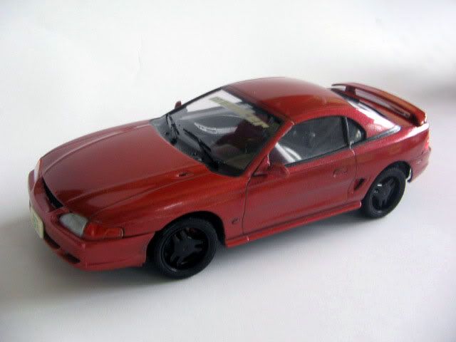

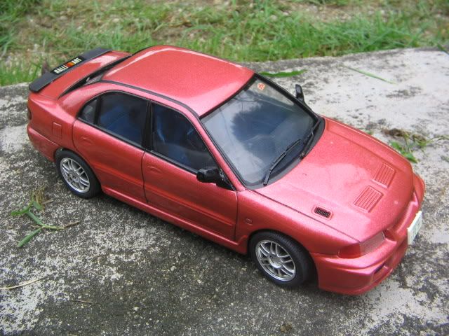

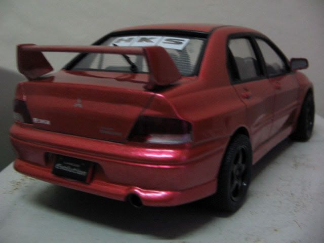

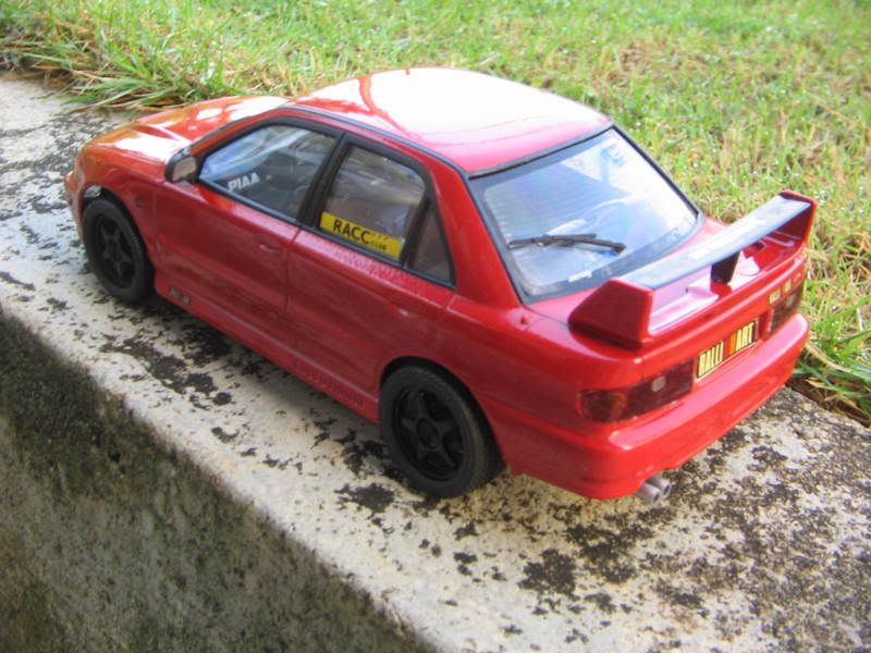

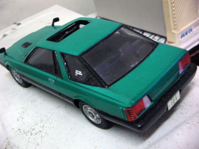

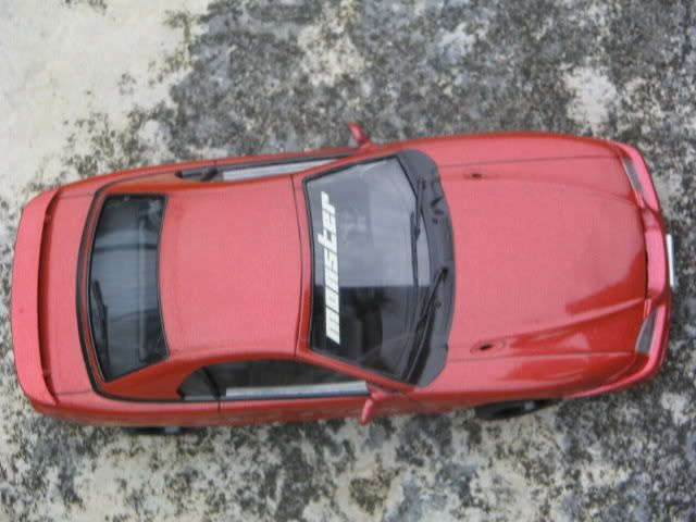

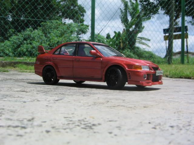

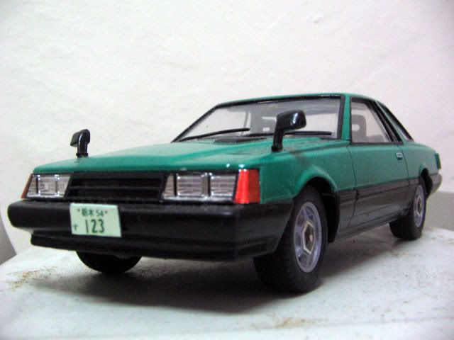

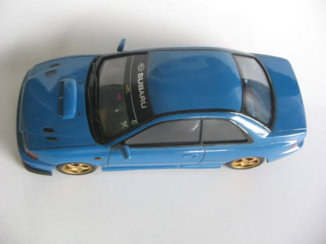

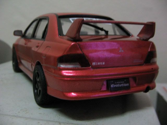

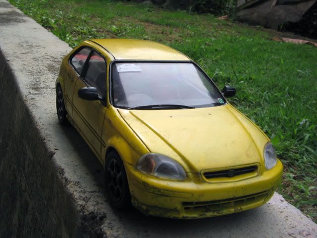

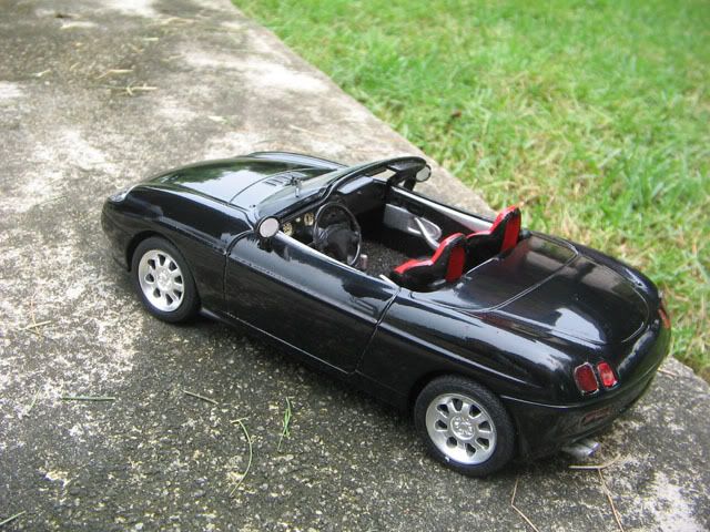

Fiat Barchetta
Mitsubishi Lancer Evolution VIII GSR
Nissan Leopard TRX Turbo
Nissan Skyline GTS R33

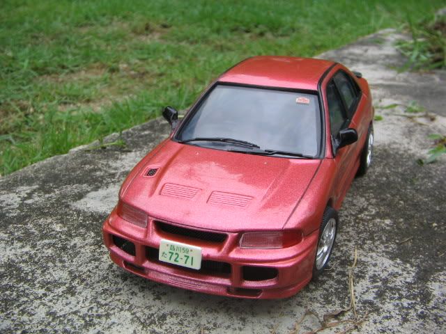

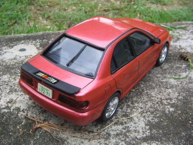

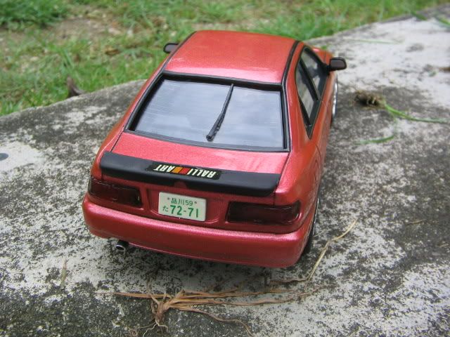

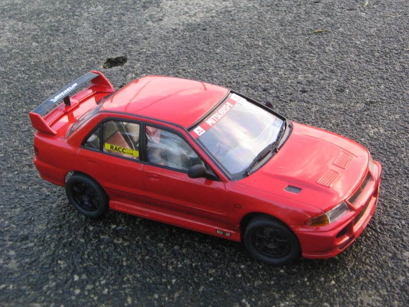

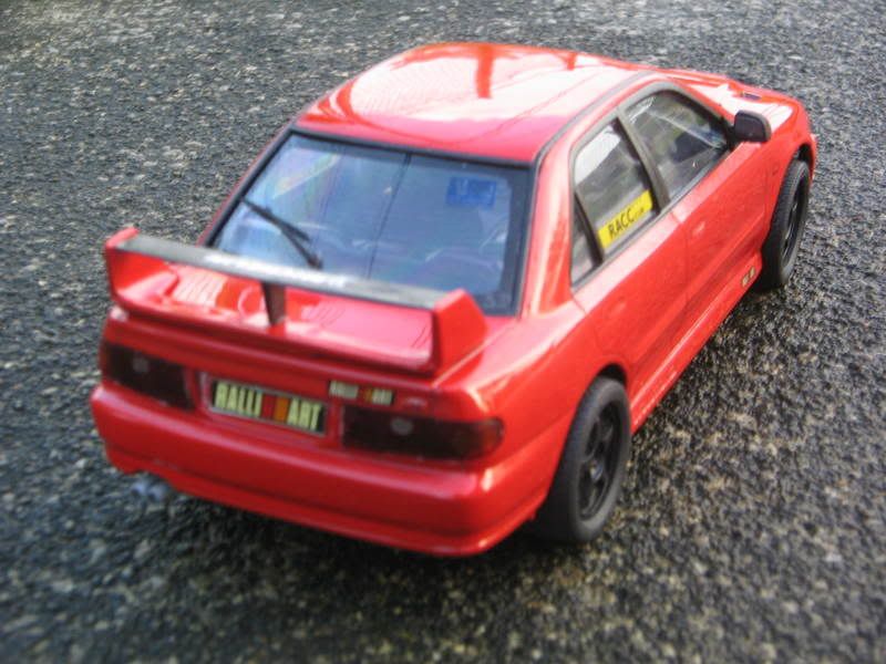

Mitsubishi Lancer Evolution III Fujimi
Mitsubishi Lancer Evolution III Hasegawa

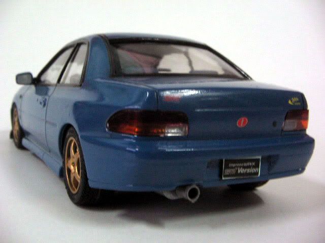

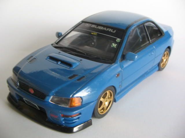

Subaru Imprezza Type R WRX
Ford Mustang

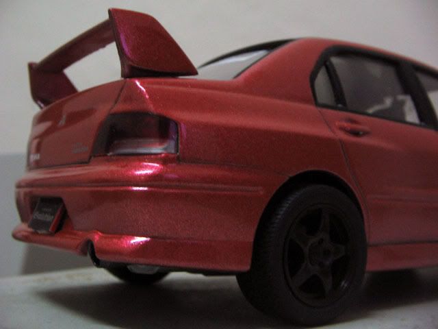

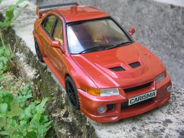

Mitsubishi Lancer Evolution VI Carisma GT

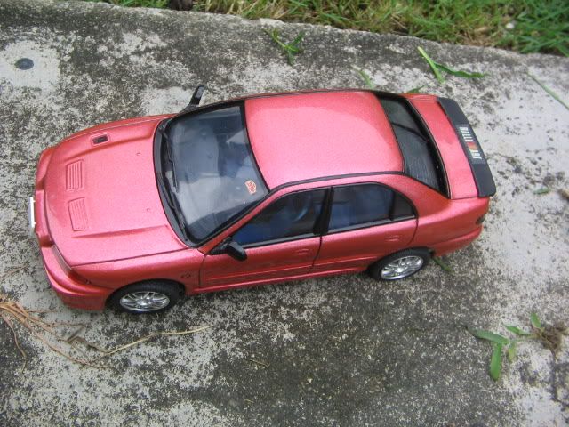

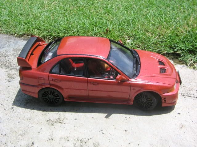

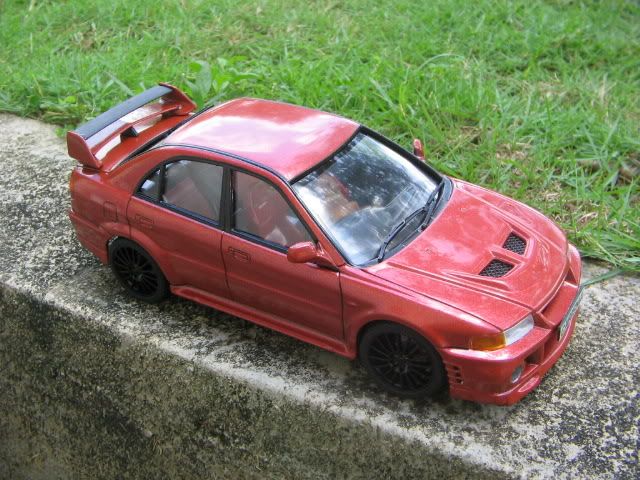

selipejepon said:
arta,
can u please post the closer pic of ur advan rg? is it from fujimi?
Yes bro selipejepon, it's advan RG from fujimi.
And my dear bro cham2020, real nice of you to post up those great photoshoot and i must admit that it's a nice outdoor shoot but...
"Let the photos do the talking ok?"
I sense insult here.. Please be nice to fellow members and respect ok? I proposed this section to TOM so that we fellow members who shares the same interest can discuss about this car modeling and even make new friends. It's good to have so much confidence but please be a humble man.
So please.. mind your manner. I havent been active in ZTH for a year now but i get such thing when i tried to be active again?
dear ARTA bro
i am not insulting anyone...
in my point of view, modeling is a kind of art and what i mean by the line
'let the photos do the talking ' means i let you guys see first the models that i build
and if you guys have any queries you guys can ask me..
i don't mean an insult here
cheers mate ;)
and i am really sorry if i offended you ARTA bro

bro selipejepon, i forgot to mention, if u wan to opt for any fujimi rim, remember to go for at least 17" and above to make the car look nice. As you can see, wat me and bro JayDM discussed, the rim sizes are off. I don't really have a closer shot of the ADVAN RG but those rims are just RM30plus so we cant really expect much ;) The rims still needs some detailing like for example the lock nuts, wheel cap hole, and like TCII rim that they painted bronze on the whole without the silver middle section. ADVAN RG doesnt look much like the real thing most probably because of it's size and it's much thicker on the 6 spoke (as in depth, not width) Good luck ;)

evo iii fujimi is based of the evo vi, v and that's why if you compare hasegawa evo iii and fujimi version , fujimi one is out of scale...
and fujimi evo iii, evo v, evo vi, evo vii, evo viii and evo ix all share the same chassis and parts.....
seriously... you can get evo iii spoiler on fujimi evo viii,evo v ,evo vi kits !!!
sharing parts..but it's fun.. you get the dashboard also LOL
