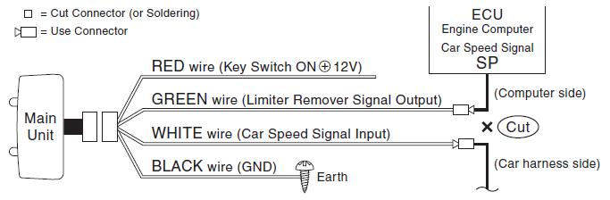

This is the wiring diagram for Pivot Speed Meter V. hopefully the wire colour is similar with yours.
