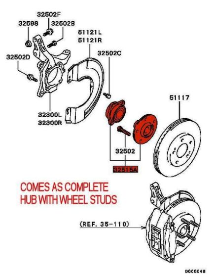

Front wheel bearing is cheap and can get at most shops. I just got my rear wheel bearing changed. The price in Malaysia is crazy. Got from sg for half the price
i changed my rear also.but cannibalized from my spare evo 4 rear hub.the rear are the same for evo4,5,6,7,8,9.got the front 1 for RM750 from Bintang Autoparts.
U got the front for 750?? Front bearing can press fit only cost rm150 per pc, changed mine before. Rear no choice comes together with hub. Ya it's the same for Evo 4 - 9.
Part no MB914617 MR223962
