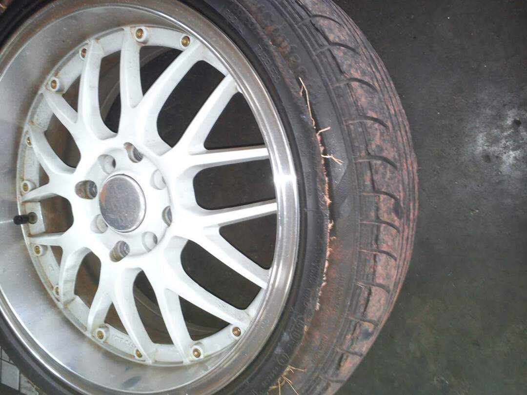

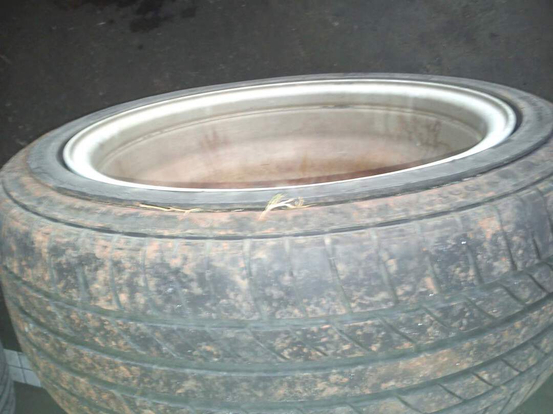

i have done the stretch tyre before..before my car tyre setup is 195/50 r16 on a r16 with 7.5 jj on rear and this is happen when i drive very fast with this tyre
Actually 195 on a 7.5jj is still borderline just before start stretching. I had once used such fitment before for a few years without problems but not ideal.
