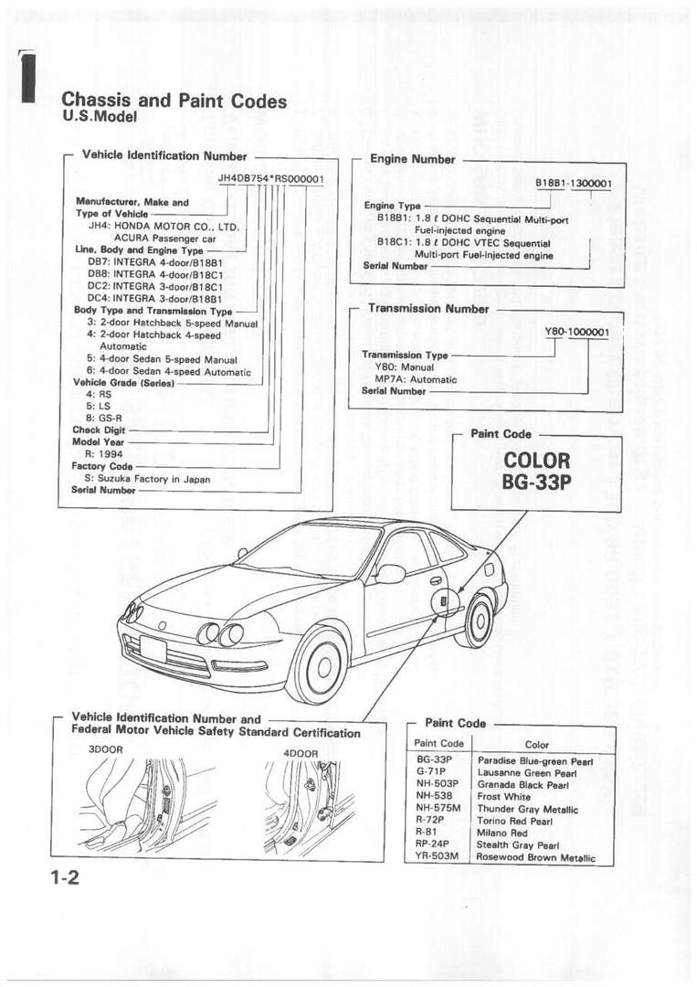

Hello everyone, as the title above, i hv got an integra db8 that i bought recently. its totally different than my 2nd gen accord. so i am very lost. need lots of help here. firstly, on the grant, no changes to the engine. but i was told that the engine block is b20 and head is b16. how can i verify this? i believe there should be the engine code somewhere. where can i look for it without too much problems? next, i was also told its a lsd gearbox. how to confirm? i know some honda lsd gb has LSD stamped on the gb such as the S80. mine does not have that. but if i am not wrong there r also some honda lsd gb without the stamp. how do i check for this. if i were to service the car, what type of engine oil would it be suitable. prefer a semi synthetic one. but need to know the brand and also the specs. is it 5w40 or 20w50. u know those figures.

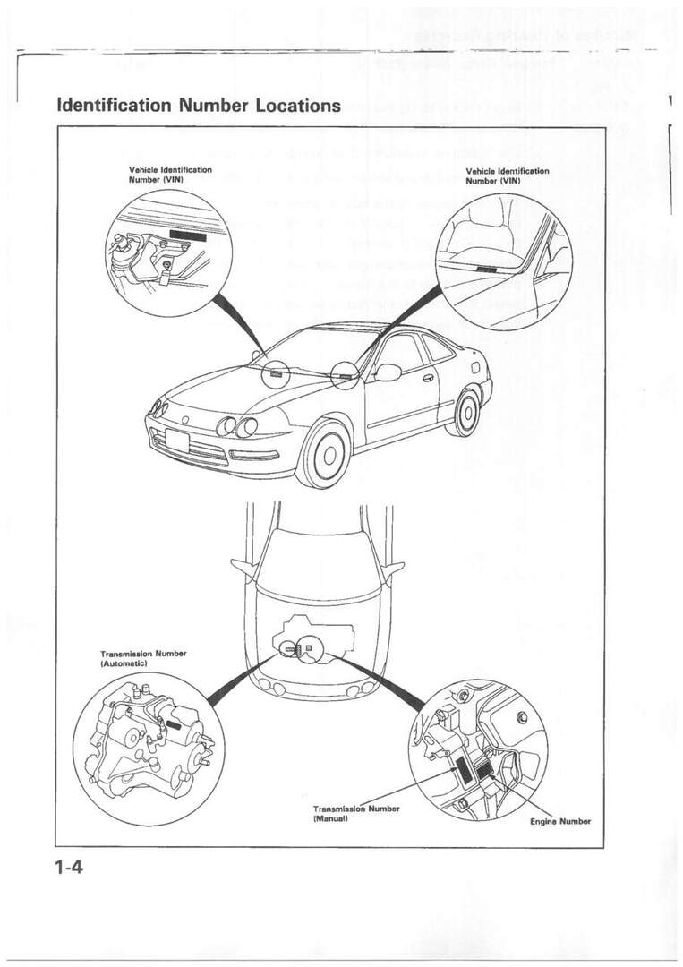

Hi.. Engine code and gearbox code locations as per the pics.. but this is US model.. think should be same or similar.. :hmmmm:

the location of the engine number is very easy.. stand in front of ur car.. open the hood... and look right to the LEFT of ur extractor.
Thanks bro. I also managed to get this owner's manual from the net. But i dont know which is the gearbox code. Btw, what integra are you using?
