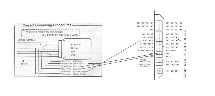

Need Help .. AVCR wiring with Microtech LT8s
talam_buruk
Feb 7, 2004
181
3,018
Rpm from microtech is IGN output 0
Microtech have no out put for speed signal from ECU.(only haltech Platinum 1000)
Thankz syahz,
If no output for speed signal from microtech..it should be somewhere we can tab the signal speed right?
I got this fixed ..some error.. in my previous wiring.. here the update.. get replied from microtechefi forum..
http://img193.imageshack.us/img193/7818/avcrmicrotech2.jpg
