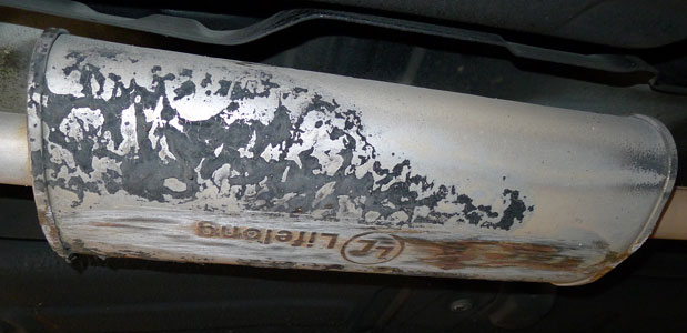

Please give me your advice on the situation below:-
I'm driving a Wira SE 2005 original settings. Recently, my muffler has eroded and when I sent it for inspection, they tell me that even my mid-box/silencer needs to be replaced. (I also got a 2nd opinion to verify this)
My main priority/intention is to upgrade the exhaust system to maximise my engine’s potential legally. Also, I’ve always been fascinated by cars with 2 mufflers and was wondering if it’s possible without reducing the performance.
I just dropped by JFA at Sunway today to get some advice and the boss advised me gave me the following 2 options:-
A RM1230
– Keep the extractor
– Remove the Cat. Convertor
– Change all piping to 2” stainless steel. RM500
– Change the mid box/silencer to a 12” stainless steel oval one with “teeth” in it RM250
– Change the muffler to a stainless steel full sized straight flow RM480
B RM1510
– Change all piping to 2” stainless steel, split it after the silencer into 2. RM700
– 2 stainless steel small sized straight mufflers. RM 280 x 2 = RM560
My thoughts are:
1. Is 2” really the optimum size for the piping? (currently I believe it’s 1.6/7”)
2. Should I change my extractors as well to achieve maximum effect? It comes in the 4-2-1 configuration already albeit is just normal steel.
3. Will having 2 mufflers have a negative impact on my car?
4. Is there any ways for calculating the optimal pressure for my engine(4G15)?
5. Please don’t advice me to change car or engine. :adore:

Today, I visited another shop in Cheras. He recommended the setup below:
- Remove Cat convertor
- Change piping from extractor to mid-box to 2”
- Change mid-box to a bullet shaped one
- Leave the original piping from mid-box to muffler (1.6”)
- Change to full sized, straight flow muffler.
Sifus, any advice?:confused:
