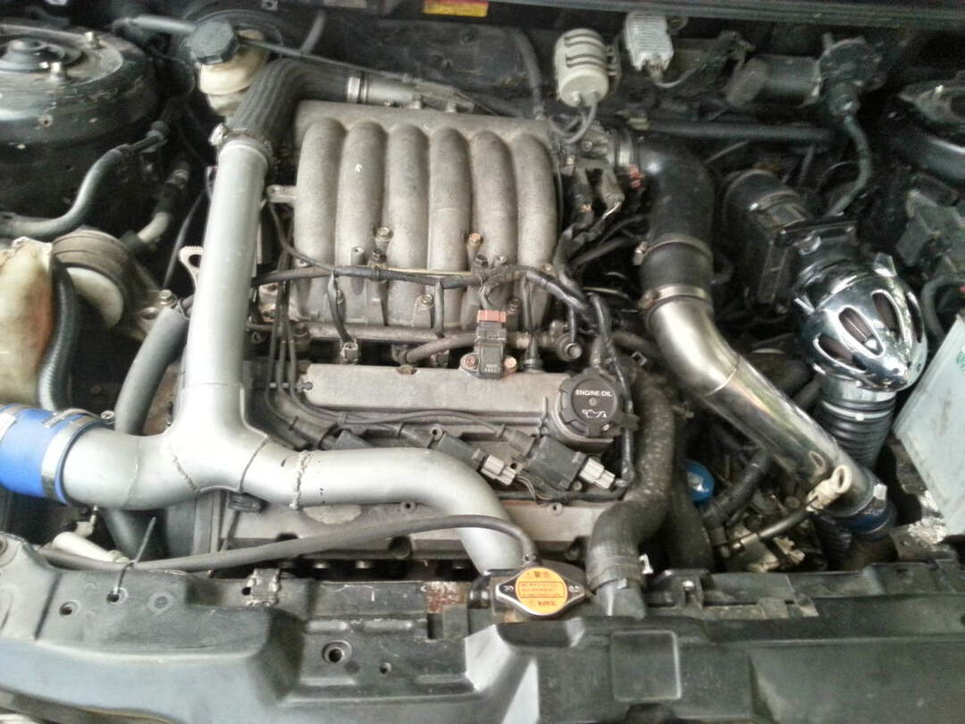

wow...it so long did not log in...my car already finished the mod but still not perfect...The gear is jerking from gear 2 to gear 3...any advice?
---------- Post added at 05:22 PM ---------- 6 hour anti-bump limit - Previous post was at 05:21 PM ----------
And last week just finished the outside cold air mod...will share the picture later
The engine
