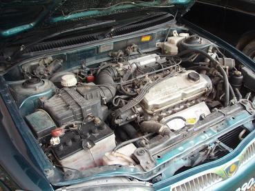

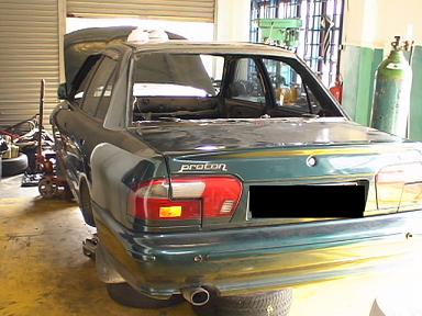

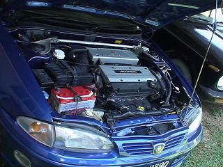

my car finally installed with 4g92 mivec, standard engine without any modification... tq guys for the guide
sorry guys.. here is the picture
engine : 4G92 SOCH -> 4G92 Mivec , clutch change to semi-racing, new "bumbung" due to the old one already hollow, new paint job from stock green to my liking blue. rim change to 16" work.
I update later, tq
