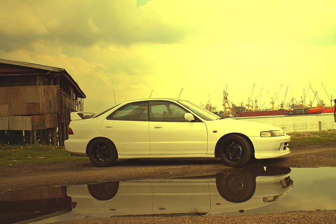

It's been a long time. Update: I'm still having this baby. Haven't been doing much lately. Expecting my 1st child soon, so i'm just waiting... Now that there's a new baby on the way, the competition is stiffer.
