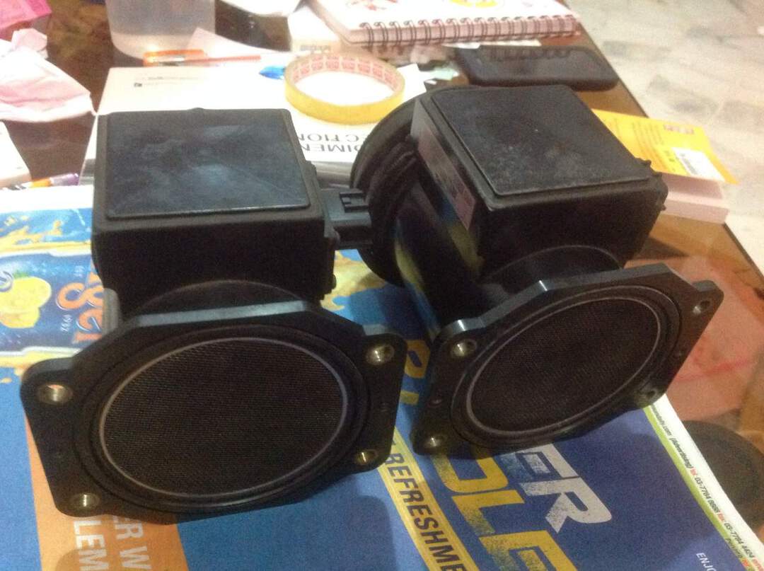

My problem solved! Weikee was right ! It was the Airflow meter , after changing it the engine ran smoothly again. By the way the afm cost about rm200-00 Halfcut condition.

I've actually wasted rm200-00 bucks to replace the afm. I've cleaned the 'spoilt afm' and installed it to my a32 , walau eh, it runs like new !! Now I have 2 spare afms! Since I have the spare afm , I have delete the mash in the afm. Suppose to give more throttle response. Will take it for a spin by this weekend.
Fingers crossed.
Actually guys you shouldn't remove the wire mesh, apart from the obvious reason of stopping some rare large debris, its actually there for a more important reason. The reason is to have a laminar air flow through the hot wire sensor, this will allow a more precise and consistent air flowing reading. Laminar flow means a straight and non turbulent flow.
