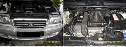

Change of engine from different brand still can proceed but you must facing so many procedure to do it.Last time I have helped my father to convert his hyundai trajet to mitsubishi airtrek turbo include tiptronic gearbox.

Better performance and handling because cruising at rpm2000,speedometer at 120km/h.Pickup as you know turbo kick.suspension already did custom at seri kembangan.So far all ok including 5 speed tiptronic.but he only complain about RON97 much expensive than RON 95.heheheheh.I have attached humble trajet for you
