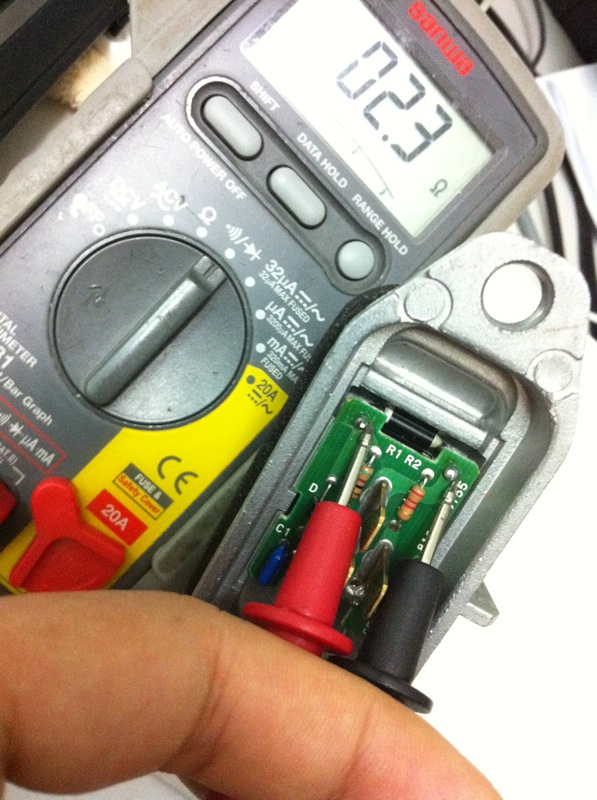

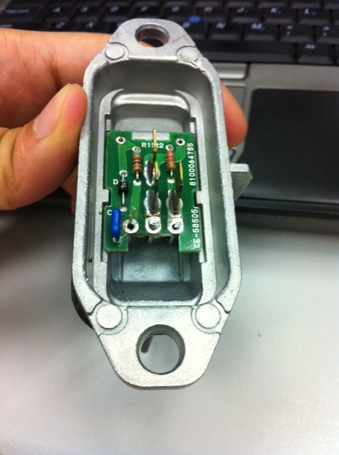

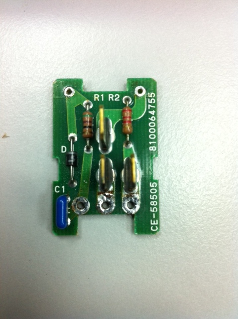

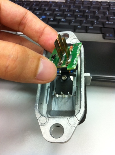

Ok, got back at home... strip the power transistor module open.
The circuit is rather simple and straight forward. Finally got the culprit. It was TCO (Temperature cut off) that is faulty.
attachment.php
attachment.php
attachment.php
attachment.php

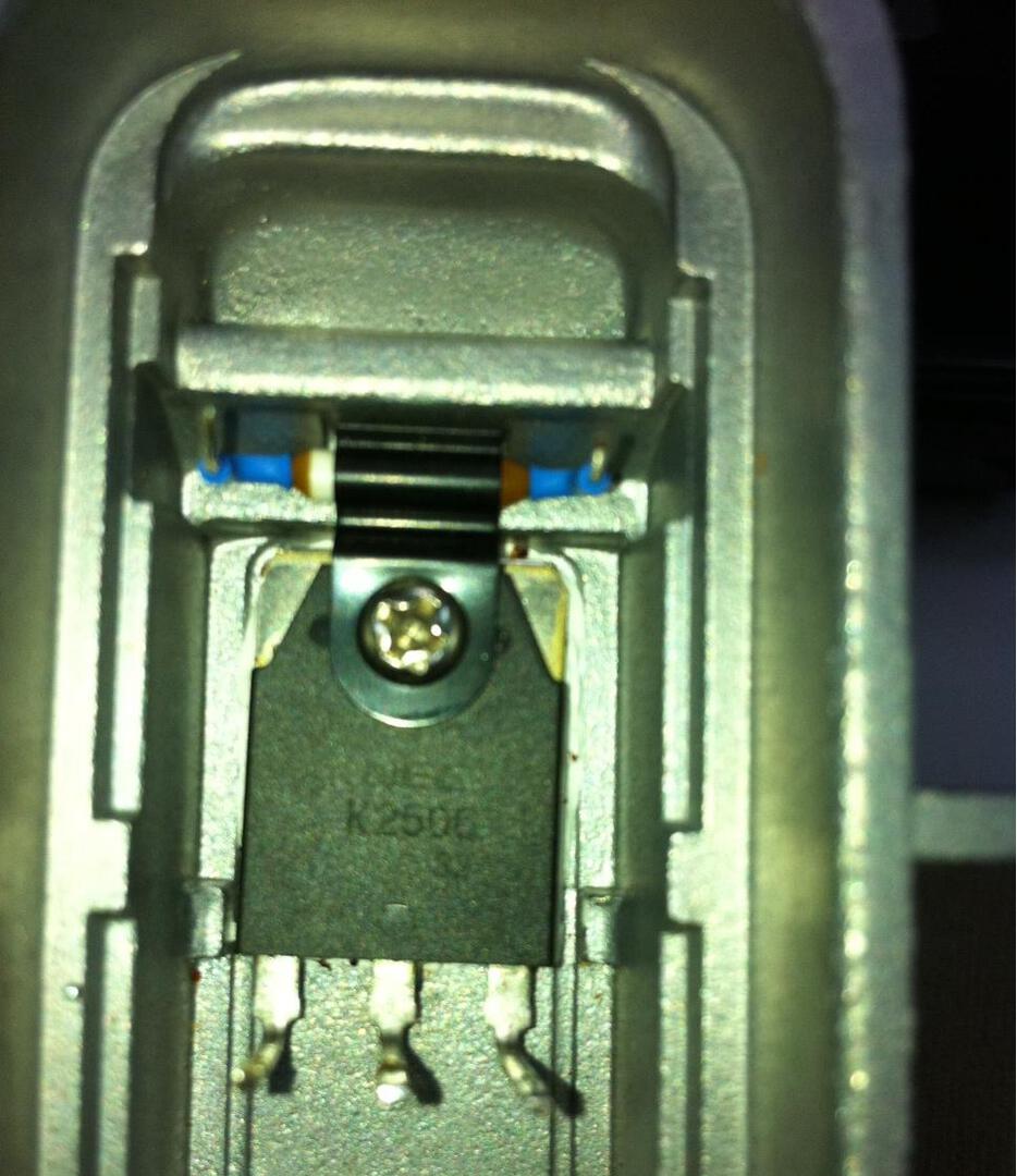

The TCO is mount on top of the MOSFET.
attachment.php
This is the TCO. Original spec was 2A, 140 Celsius. I unable to get the same spec in electronic shop. So, i got 2A, 110 Celsius. Cost only RM2.00.
attachment.php
After solder everything together, tested on the car and whola! It just works.
