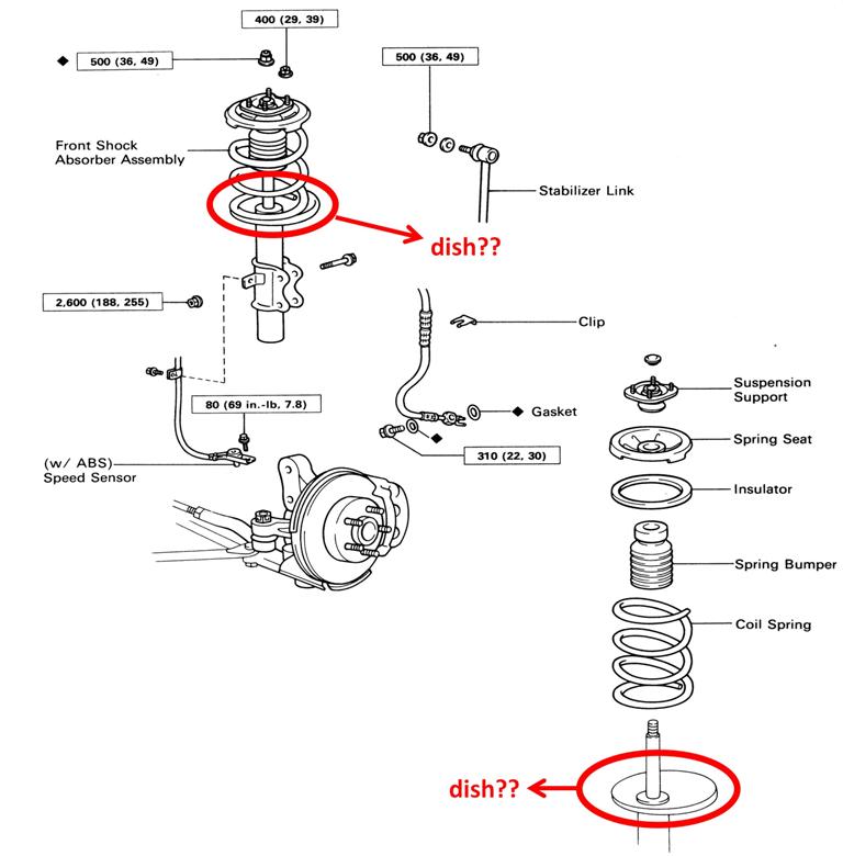

hey guys,
just bought 17" rims and found out it didnt really favour the stock suspension as my front right wheel has approx less than 1mm gap (trust me im an engineer =p) between the wheel and the suspension dish(i dont know the name of the thing but it looks like a dish, probably you guys know better)..so i am considering these options:
1. buy apexi suspension from mudah (from dominic)..it costs me huge since i just started working few months ago..still, i have to estimate the labour cost ughhh...
2. ask mechanic to 'bend' (or ketuk sikit laaa) the dish, so that the gap become larger (is this feasible and practical?)..this is because my front left wheel is just fine, gap about less than 2mm..so i am a little bit curious why the right front absorber is "NG"
3. buy new tyre with less ratio??? (NO!!money again...huhu)
i know dominic is here but i dont his nickname....but i hope that somebody can guide me..
btw also need some help in repairing t-top leak (typical eh =p)
thanks!!!!
btw here is some illustration to clarify what i mean by 'dish' hahaha
in addition, i would prefer not to use spacer, but will consider as super duper last resort...

Never compromise for this kind of things… get a better offset rims. Run a search for the MR2 proper offset, worse case use a spacer, but in my opinion never ketuk anything, not a good long term solution.
Apexi or other after market shocks have smaller shock tower (or whatever u call it – where the spring sits) but they have a thicker body then OEM. So make sure the fit is right before committing.
Also your tire height is wrong… like TOM’s mention you need a lower profile.
