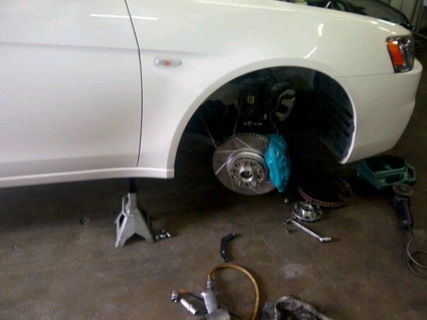

6. 4 Pot Sumitomo Brakes
Short list compared with previous WRX!

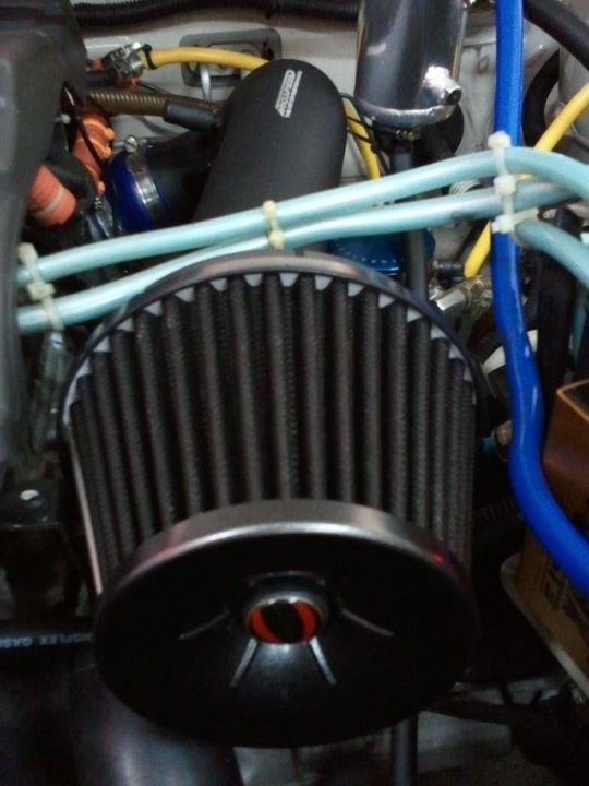

i have attached a pic of arospeed air ram and simota filter. looks nice as the ram is coated with heat resistent coatings
I put in a Cast Iron 4 - 2 - 1 Extractor from Kaki Exhaust
Yes Decat gives you better throttle response
With your open air filter, has your throttle response improve
haven't get it yet. quoted RM280 only for the air ram and filter. wanna get it but not sure about simota air filters. lolz. throttle response should improve with SRI and open pods. sound effects will be nice too. lolz. will let u know if i put it in. need to make a heatshield too. wanna get it together and make our own heatshield? hahaha

MyDVDrom - be careful with the arospeed air ram. It made my engine stall.i bought the arospeed and another similarly designed but without the black coating.BOTH made my engine stall. in my opinion, the piping diameter is too big for the MAF sensor.
