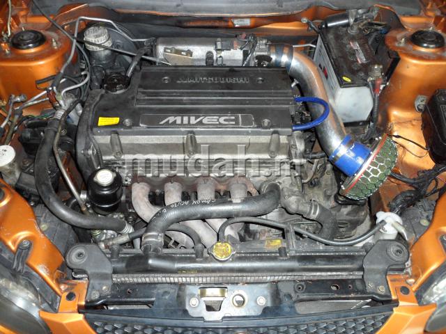

I came across a satria neo Mivec 1.8L, at least that's what the guy told me.
I'm curious I thought mivec only came at 1.6L?
:confused::confused::confused:
Take a look at the photo, I need to know if this mivec has the same power as the 1.6?
I only know 4g93 has 1.8L but no mivec, and then Mivec Dohc is the 4g92 1.6L
I'm new guys sorry I'm a noob.
My main point is that, is this engine as powerful as the 1.6?
There is no 1.8 L MIVEC produced. When people say that, it is a hybrid between MIVEC 1.6 head and 4G93 block. More torque. About power, I not sure. Should be more also la... Quite a number of people do this mods ah... Honda also got B16 head with B20 block.
its a hybrid.. mivec ck kawin with gsr ck block. just like how they used to do it with the previous gen proton's but with the newer terbalik model 92 and 93 engines from ck chasis
combination of 4g93 block with 4g92 Mivec cylinder head. definitely more powerful :)
