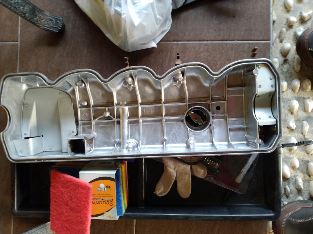

Update....Gasket arrived yesterday and when i drop by at the 'workshop' i discovered that the timing chain cover and the valve cover is cleaned.
My bro is working on grinding the valve.
So far so good. We will find a way to clean the intake without removing it from the engine bay if possible as other parts are just too cleaned.

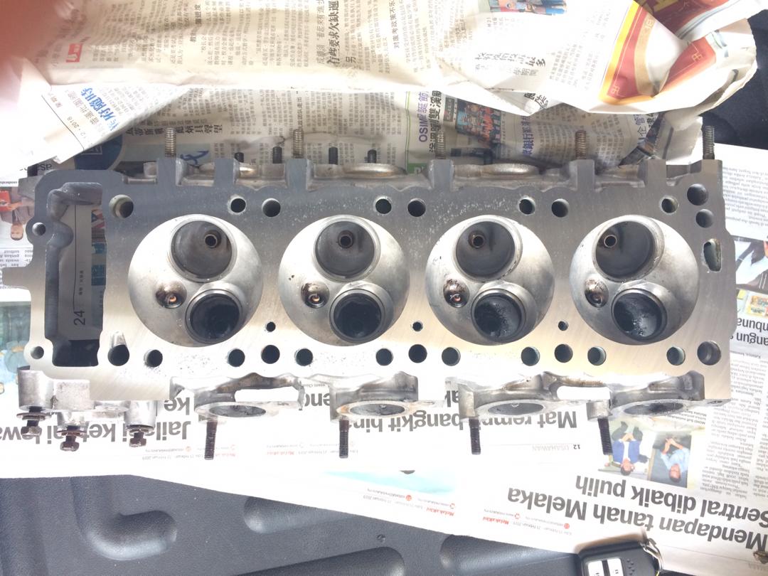

Valves are grinded, carbon cleaned and sent to be resurface...All too shiny, belong in a display cabinet;
Cost RM30 to resurface.

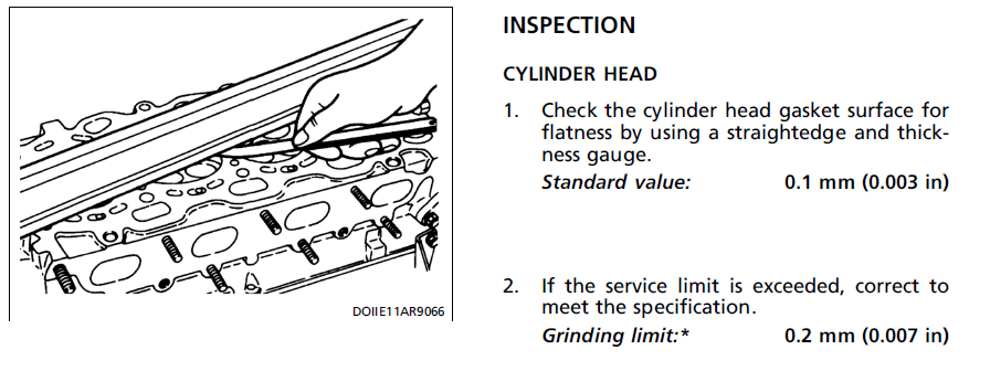

Based on the manual, only can skim up to 0.2mm max.
Based on measurement using straight edge and thickness gauges, my head warped 0.08mm
How to determine/know the foreman/specialist didnt resurface more than 0.2mm.
How about ur case? How much the guy skim ur engine head?
hahaha...i also dunno.
i guess they just resurface the thing judging from the cheapo cost.
