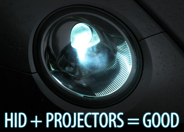

Hello guys, people have wrong ideas about HID and projector lights. Now you be the judge. I have made the mistake of putting HIDs in reflector housings but after doing an extensive research I have come to the conclusion that HID should only be used in HID Projectors Only.

Projectors come in two different types. 1.Halogen 2. HID .... Now aftermarket projectors that are sold ... 99.9% of them are Halogen projectors ... but as everyone does not know this , they put HID's in the Halogen Projectors and the output is ridiculous to say the least.The reason is because the focal point of the halogen bulb is different from the HID bulb.

That is also false, HID in reflector housings gives the worst output.The glare you get is blinding to say the least.Most of the folks put HID in halogen projectors and then complain that the output is worse.
Here is the output of light in descending order: HID Projector>Halogen Projector>Reflector Housing.

All of the projectors headlamps available at car accessory shops are Halogen, most of the people do not know this, and when they buy them and put an HID Kit in the projectors, they start complaining of the lack of visibility.
A simple way of identifying a halogen projector is that it simple uses any of the halogen bulb types for example like H11,H3 etc.
Real HID Projectors use HID bulbs like D2S,D1S etc.

Now you all be the judge.I have made the mistake of putting HID's in reflector housings but after doing extensive research I have come to the conclusion that HID should only be used in HID Projectors Only.
