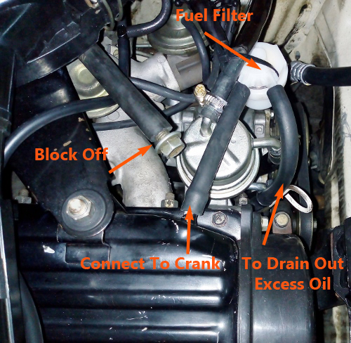

This is what what the workshop did for me this afternoon. Fixed a white color plastic fuel filter. One tube is connected to one of the outlet at the valve cover, while the other outlet is fixed with a hose placed facing downward, to drain any excess oil should it get full. The outlet from the air filter case is now blocked off. Is this the right and proper way to do it?
You can do it that way but instead of venting out to atmosphere, should connect back to manifold, the fuel filter will act as filter. When filter is dirty, just change it. I am doing it on both my old VR and old Hyundai....lol

I remember adding a mini breather in the middle of the valve cover too to reduce the pressure. I can't remember! DAmmit

Wait, what did I tip you? Oil catch? Yeah that's usually a good idea in most cars. Especially more on direct fuel injection cars.

For emissions purposes all cars usually recirculate the blow-by back into the intake, so if that blow-by is oily, it'll just gather in your intake and result in lots of oil vapour and all caught in the filter or intake area. A higher compression also partially contributes to more pressure in the system aggravating the whole vapour situation. That's why adding a oil catch tank (or in your case a cheap petrol filter acting like an oil catch) stops all that oil vapour from recirculating back in to your intake.
