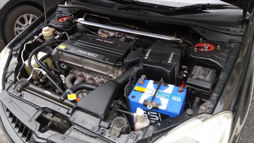

<blockquote data-quote="Nightstalker1993" data-source="post: 1064710158" data-attributes="member: 100539"><p>Yeah that seems to be about right. I need to relocate my pressure sensor onto the sandwich plate as well to see the difference between pressure at the head and at the block.</p><p></p><p></p><p></p><p>That's crazy pressure man! Should be well more than enough for the Mivec to kick in! Did you test the solenoid manually by connecting it to 12v and hearing for the audible 'click'? Are you using the Mivec or Mivec RS engine? There SHOULD be an audible switchover when the Mivec engages, unless your exhaust is too silent :sleep:</p><p></p><p>Would recommend you to change back to 40w oil though, but honestly I don't think the oil grade would affect the power by much. As vr2turbo mentioned, can't do a 1st-2nd gear pull to redline?</p></blockquote><p></p>
