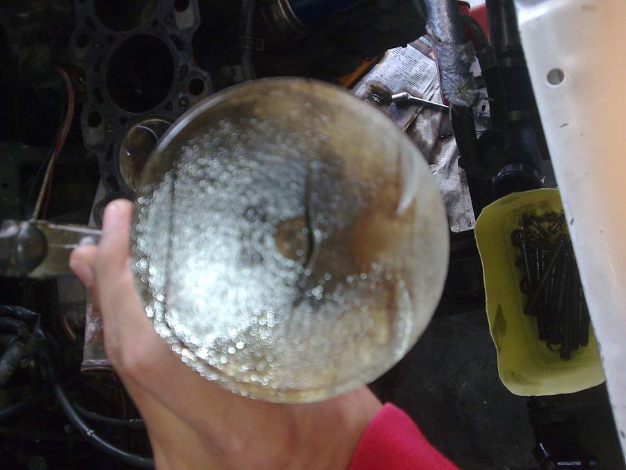

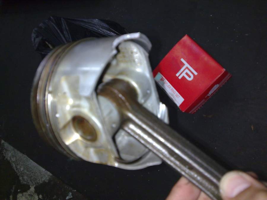

Below are the pics of damage done by alignment shop. Very dissapointed of d misfortune, i cared for the engine with love :bawling:

why did your piston crack in the first place? even though tarik kaw kaw from a good tuned engine shouldn't face any problems. was it overboosting? insufficient engine oil causes your crankshaft to fail on you? diagnose what causes the engine failure first before buying all those "not" needed parts for your rebuild otherwise same thing will happen again.
Example, you and your mech overlooked the weak fuel pump and or oil pump. Even if you use the best available forged pistons and conrods.. they will still be destroyed due to lean airfuel mixture. Get it?
Yo Lazarus, long time to hear from you edi man... now your project car all completed edi? any more monster parts you need ah? call me man if you need it.
The car was not fully tuned when i went for alignment. Plus i forgot to off the boost controller. Of course the problem is fuel too lean. I think the culprit behind this is the oil screen not properly mounted or torqued. Messing with my oil press thus damaging the rod bearing.
After the run-in period i changed the oil, and there was a small nut in my sump. Luckily i used the magnetic sump nut so the nut stick on the sump nut. My previous mechanic said maybe the alignment shop didn't tighten the screw strainer nuts. Plus my dipstick was stuck on something, oil level on the dip stick is always below low even though i poured in 3.5 liters of fresh oil. God knows what else the freakin shop left inside my sump.
