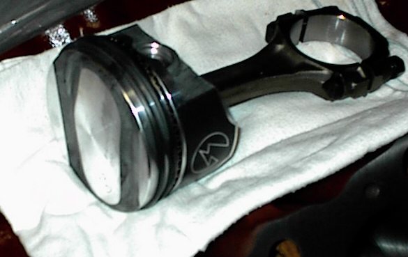

hello all...
does anybody know any pistons from any engine which has bore around 78-79 mm n stroke around 83-84 mm and can withstand a compression ratio of 11:1?
I know, some might say this might be a 'long shot' search n I'm better off with a custom pistons. However, im trying to reduce cost in rebuilding my engine. Sharing of any info regarding above is greatly appreciated..
thanks in advance..

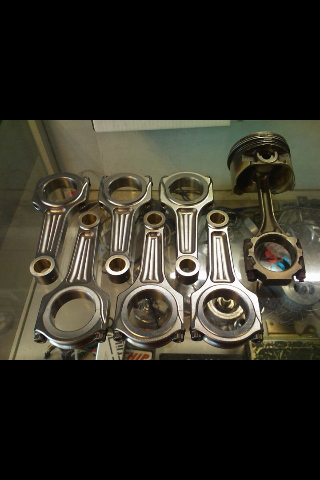

Here is some technical spec and piston photo. Hope can help you.

mines998: its for a kia spectra engine :). btw, the pic u attached, is it a set of custom JE Pistons? How much did u buy it? including custom conrods?
^pomen_GTR^: although a 1zz's bore might be a little bit too much for my first bore up, I will still consider ur recommendation as one of my options.. thanks..
Ya is a custom made piston for 6A12TT engine 6pcs a set I think around 4k including freight cost. Con rod is made by other shop about 4k aswell. Need to wait for 2 month and send yr original parts to them for fabricate.
