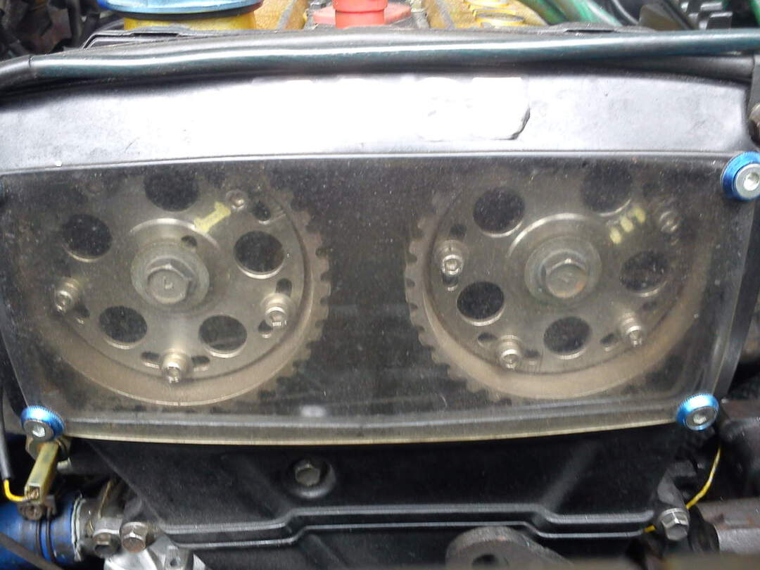

- Adjustable cam pulley.. both intake & exhaust

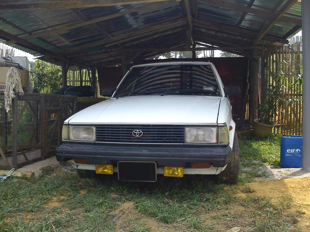

Here's my 'new' KE70..
http://www.zerotohundred.com/newforums/members/d7zul-albums-my-new-ke70-picture7298-ke70-front-2.jpg
http://www.zerotohundred.com/newforums/members/d7zul-albums-my-new-ke70-picture7296-ke70-4k-2.jpg
http://www.zerotohundred.com/newforums/members/d7zul-albums-my-new-ke70-picture7300-ke70-rear-1.jpg
http://www.zerotohundred.com/newforums/members/d7zul-albums-my-new-ke70-picture7299-ke70-front-1.jpg

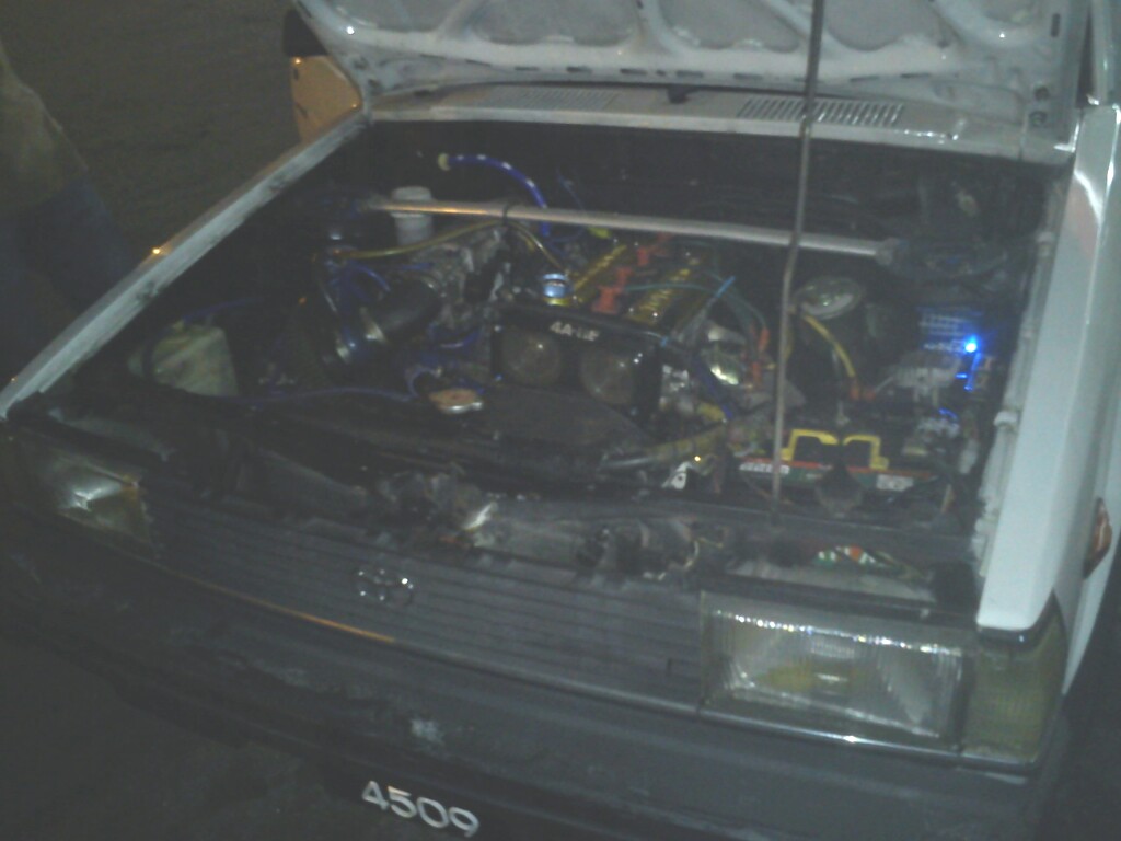

here's a sneak peak of my dad's KE70 4AGE..
more pics coming soon..
and yeah.. i know.. it's white too
:biggrin:

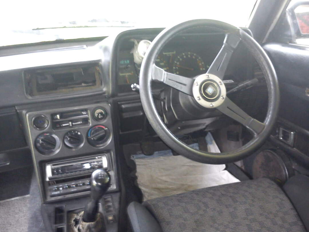

finally, my dad's car pics are here!!!

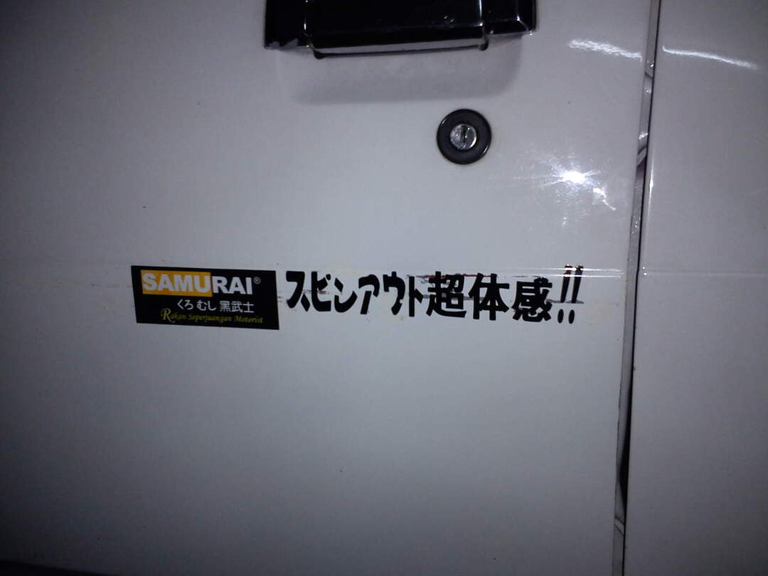

anyone knows what these wordings meant?
Bro ur dad's ke70 is running on a carina half cut. hehehe. the dash is slightly longer than the ke70 and 86 cause its a bigger car. hehe but the rev is 9k compare to 8k for the 86. Nice ride..
I got the ori carina w black top but got stolen. Now runnin a 71 w 86 heart..
hehehe...
If got the ori carina w black top but got stolen. Now runnin a 71 w 86 heart..
hehehe...
serious???
i haven't had the chance to be 'alone' with the car to test the 9k rev cut.. hehe
thanx 4 pointing that out..
i'll keep u posted
:biggrin:
スピンアウト tu maknenye spin out
超 tu maknenye sangat/super
体感 tu maknenye feel/experience
so スピンアウト超体感 maknenye macam really/very very feel the spin out! :burnout:
Special thanx to doritezza for translating
